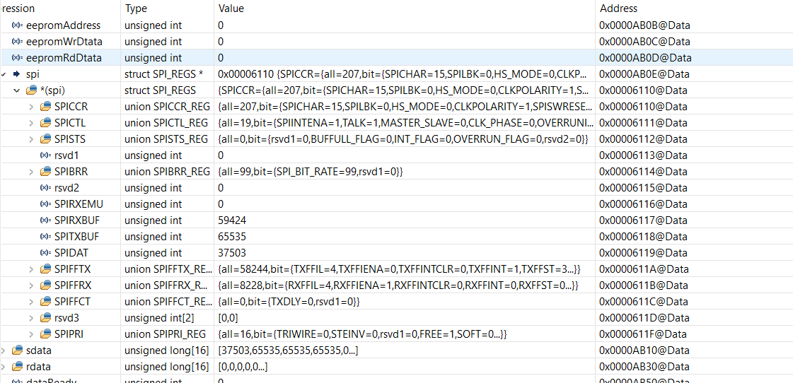

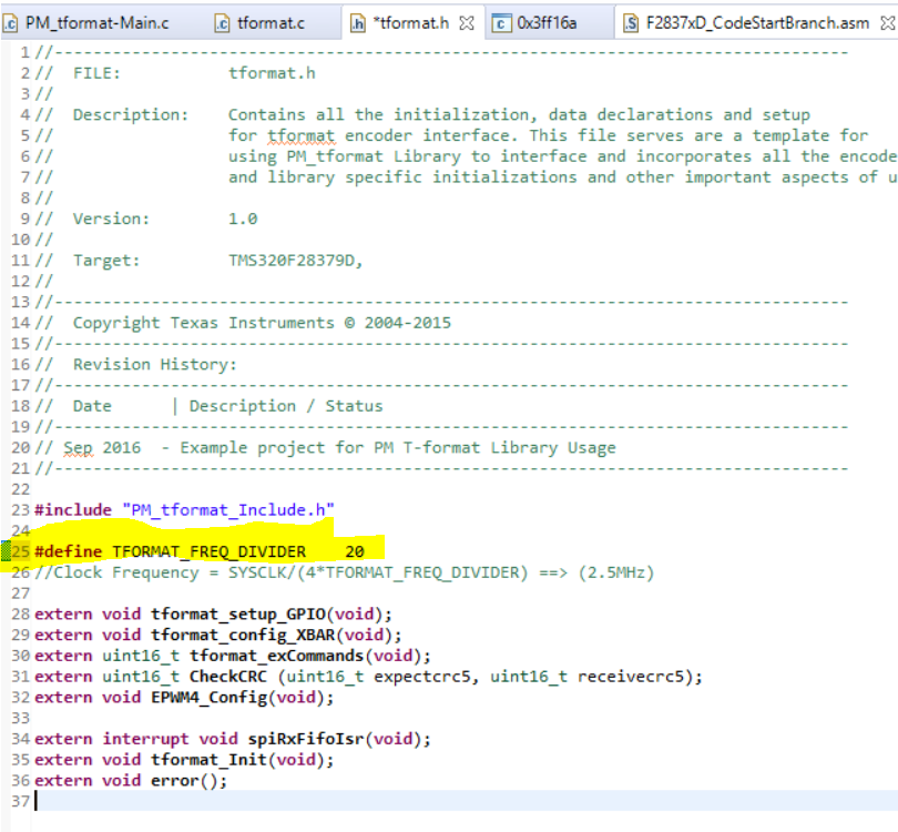

  • I don't see any activity on the interface when the serial input from the abs encoder is connected to the board. How do you change the Interface frequency, I don't know what my current setting is. The following screenshot is tformat.h file, which shows my TFORMAT_FREQ_DIVIDER = 20. What do I change to make it run at 2.5 MHz.
    I have also attached a screenshot of variables when the project is running.

    If you are runnign with default configuration of 200MHz system clock then, as the equation suggests, your t-format frequency will be set to 2.5MHz.
    So, no need to change the values.

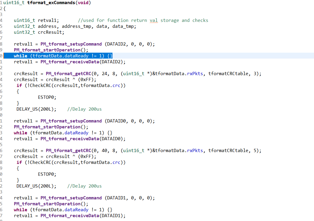

    Where does the code stop when you run the test? Is it waiting for encoder response?
    It looks like the code is stuck the line, shown below, when paused and never proceeds further from that line (while (tformatData.dataReady != 1) {}).
    Therefore, the data is never ready.
    I have also attached the screenshot of the SPI interface signal, but they don't change when the motor is moved.
    What signals should I scope?  The output of the ABS encoder is outputting the correct Manchester encoded data on the scope.
