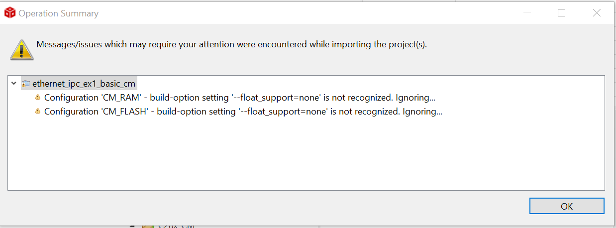

    Also, I am having issues when I am trying to import the library from resource explorer:
    Khushali Mehta.

  • Hi Sudharsanan,
    I am able to build successfully  ethernet_ipc_ex1_basic_c28x1 project and not ethernet_ipc_ex1_basic_cm program. Also, all other programs I am using c2000 compiler and it is working fine. Can you please elaborate why I will need to install TI ARM compiler?

  • Hi Sudharsanan,
    Khushali does have the ARM compiler and it is used if we try and compile the enet_lwip library. However when we look at the properties for the  ethernet_ipc_ex1_basic_cm it already has the C2000 compiler defined and it will not allow us to change it. Is there a way that we can change it?
