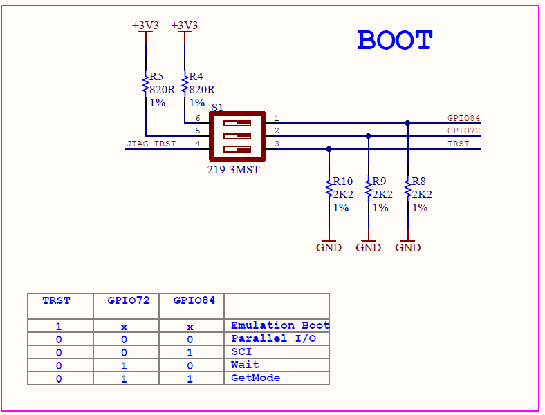

I have a LaunchXL -F28379D developement kit.
At the beginning when I am powering up the board the The pre-porgramme in the given below does not work.
"The LAUNCHXL-F28379D includes a pre-programmed TMS320F28379D device. When the LaunchPad is
connected via USB, the demo starts with an LED flash sequence. After a few seconds the device switches
into an ADC sample mode.
Every 1 second the ADC samples pin ADCIN14 and the sampled data is represented as follows: If the
sample is above mid-scale (2048), the red LED D9 will light. If the sample is below mid-scale, the blue
LED D10 will light. "
The board remain still with the LED's ON. no blinking. I cannot put any program into it. NOt even with CCS.
How can I RESET the whole system and How can I erase the memory.
So that I can do a fresh start from the very beginning.
