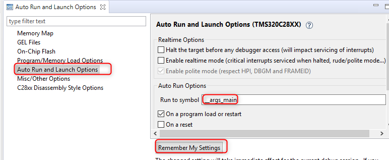

    yes it seems to have issue with the auto-run to main breakpoint. I suspect the issue is related to the below FAQ:
    https://e2e.ti.com/support/microcontrollers/c2000/f/171/t/714009
    The debugger sets the breakpoint for main before the copy happens. Since it is a "hidden" breakpoint, it does not appear in the breakpoints view and the breakpoint toggle workaround does not apply.
    Hence try the below instead. Change the auto-run symbol to __args_main like below:
    Make sure you press the "Remember My Settings" button.
    Then relaunch the debugger for the project. It should halt at __args_main, right before main is called.
    You can then step into main without issue.
    I also noticed that if I resume execution from this breakpoint and then terminate the debugger, the program still runs fine. Looks like the screwed up SW breakpoint at main in the scenario before is the culprit for that issue also.
    ki
