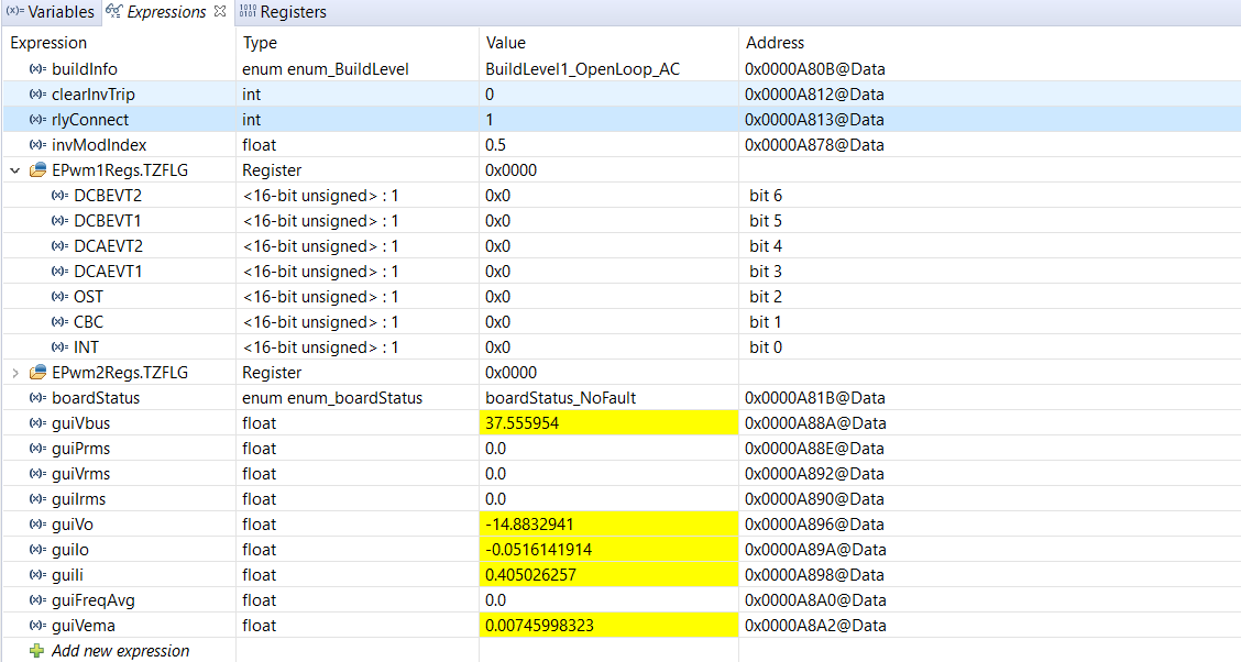

CCS/TIDM-HV-1PH-DCAC: Show values in gridConnectedInverterLCLFltr_F2837x
Part Number: TIDM-HV-1PH-DCAC
Because Vbus too high and very dangeros for the labtory. I divided Vbus 10 times (=38V). However, during the BUILD1_OpenLoop_AC Testing in Grid mode, the value of guiFreqAvg is still zero , although the value of guiVbus equal max value input. but I don't see value of RMS such as guiVorms,.....? can you tell me why? and how to fix this problem?
