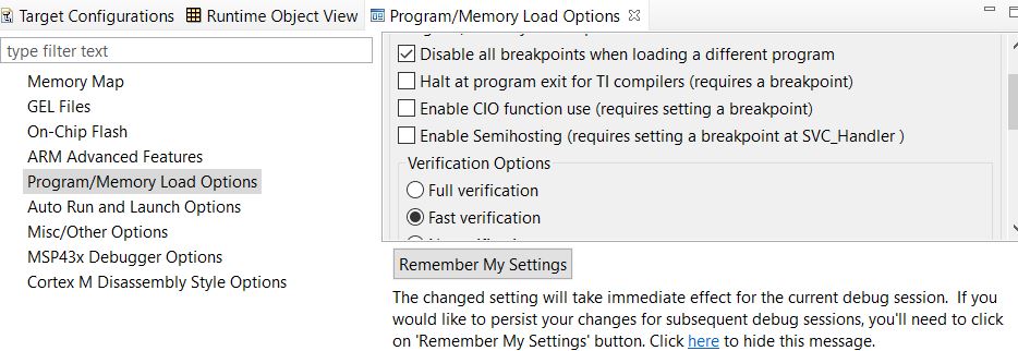

I am able to run this tcpEchoF2838X sample project successfully by sending data to the server and getting the echo data back. However,  the target did not run to the symbol "main". Also, I am not able to set any break point in the code and keeps getting: "Error Enabling this function; There is no AET resource to support this job."

    When I need breakpoints on Flash based projects like the TCP Echo example I do below in Tools-> Debugger Options->
    Since the number of hardware breakpoints are limited when debugging on Flash, I usually disable the settings like above that frees up breakpoints and I keep breakpoints to run it. It will also let you do Go main. Also place break point at the code line I need.
