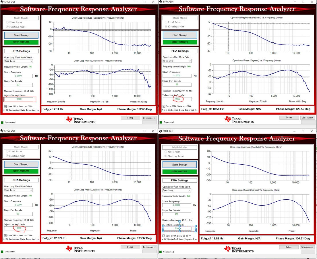

3. I have done some tests on this feature, and set different value for Ref, and see the sweeping result is different, what’s possible reason of causing this? The closed loop structure is the same as question 1, and the only differece in below 2 results is the Ref difference.

    3. Seems to me something in SW is saturating when you inject during Ref 0.5,

    3. I have done some test on it, and call DCL_runDF22_C1 without clamp feature. And set injection amplitude to 0.002, 0.005, 0.008, and 0.02. The result is related with injection amplitude when set the Ref to 0.5. Please see below result. Here is my testing code.example1_stb_f28004x_f32_coff.zip

    How about the 3rd question? I set the Ref = 0.5, and use different injection amplitude, 0.002, 0.005, 0.008, 0.2, the sweeping result seems have differences. The result seems not very good when Ref = 0.5 with using 0.002 INJ, but Ref = 0.03 with 0.002 INJ is good. What cause the differences?

  • Hi Manish,
    May I have further comments from yours for the 3rd question? Thanks...
  • Jack,
    With injection increase you are improving the SNR of the SFRA measurement, That behavior is expected. However one cannot increase injection amplitude too much as well because that can cause operation outside the linear region.
