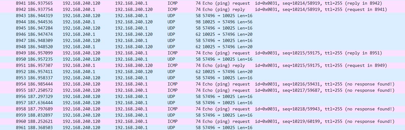

    2. But I need a wireshark trace to understand that further. will it be possible to capture it in wireshark and send the trace for further analysis
    => Below the wireshark log text.
    the Rx_FIFO_Overflow_Packets count is over 0 after 10216 sequence icmp packet(above the scenario, the registor value is 20).
    Thanks for this detail souds like the received packets are not dequeued which results in this scenario. Can you please let me know if the application is still running or hits a fault and aborted? Does the Ethernet_rxInterruptCount variable increase post this scenario.
