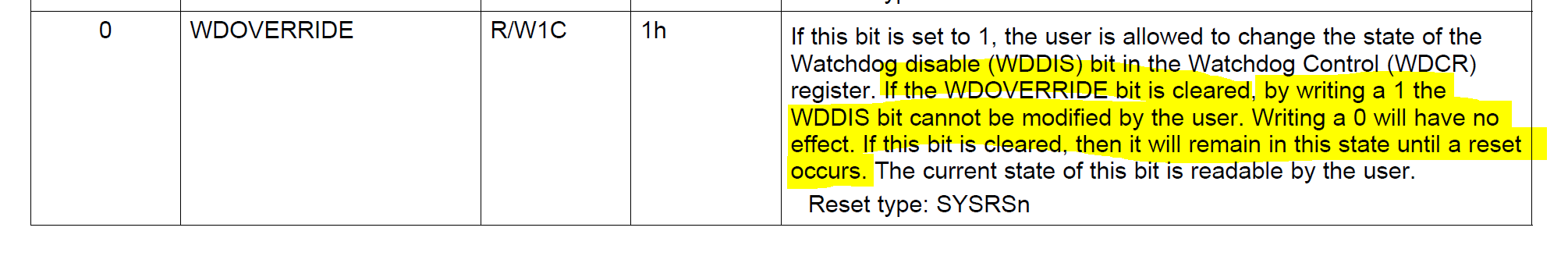

  • WDOVERRIDE should not be '0'. If it is '0' then user can not change this to '1'. It only get set to '1' by reset. Are you changing that bit to '0' in your code ?
    Vivek Singh
  • My full code is the program above (I want to test with a simple program), so I never change WDOVERRIDE bit to '0'.
  • You have this code -
    //2. Configure the Watchdog to generate a reset signal
        EALLOW;
        WdRegs.SCSR.bit.WDENINT = 0; // Generate a reset signal
        EDIS;
    This is read-modify-write operation which will read the OVERRIDE bit as '1' (default value is '1') and then write '1' hence will clear the OVERRIDE (it's write '1' to clear bit). Please change this code to write full register with updating only field which is needed.
    We have this note in TRM in section "3.15.4.1 SCSR Register (Offset = 22h) [reset = 5h]"
    "It is recommended to only use 16 bit accesses to write to this register. Use a read-modify-write instruction
    may inadvertently clear other bits."
    That should fix the issue.

  • Vivek,
    In my case, after watchdog disable, I'm in the goodconfiguration (WDENINT = 0, WDOVERRIDE  = 1), so I don't have to modify SCSR register.
    But to try what you've said, I've tried to write WDENINT = 1 by 2 ways :
    • Writing the full register : WdRegs.SCSR.all = 0x0003;
    • or
    • Using a "or" to update only field which is needed : WdRegs.SCSR.all |= 0x0002;
    In both case, WDOVERRIDE  change to '0' after this line.
    What's the right way to do it?
  • Both method will clear the bit because you are writing '1' to WDOVERRIDE bit. You need to write '0' to WDOVERRIDE bit when updating other bits.
    Please see below snapshot of this register bit definition in TRM.
    Hope this helps.
    Regards.,
    Vivek Singh
