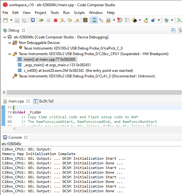

I have a tms320f280049c and trying to program using xds100v2
Currently the 280049c is in boot mode wait.
When programming in debug it looks like the progam is loaded and I get to the first break point.
when I hit run the following errors are shown.

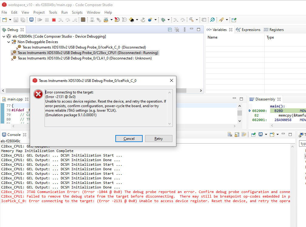

C28xx_CPU1: JTAG Communication Error: (Error -1044 @ 0x0) The debug probe reported an error. Confirm debug probe configuration and connections, reset the debug probe, and retry the operation. (Emulation package 9.1.0.00001)
C28xx_CPU1: Failed to remove the debug state from the target before disconnecting.  There may still be breakpoint op-codes embedded in program memory.  It is recommended that you reset the emulator before you connect and reload your program before you continue debugging
If I attempt to reconect to the processor without power cycling I get
Error connecting to the target:
(Error -2131 @ 0x0)
Unable to access device register. Reset the device, and retry the operation. If error persists, confirm configuration, power-cycle the board, and/or try more reliable JTAG settings (e.g. lower TCLK).
If I try and just flash the processor it goes through the load process and hits the same errors.

  • Im seeing the errors reported in  CCS.
    So I can connect and load target
    but it then when releast the target I get the following errors and am unable to reconect without power cycling.

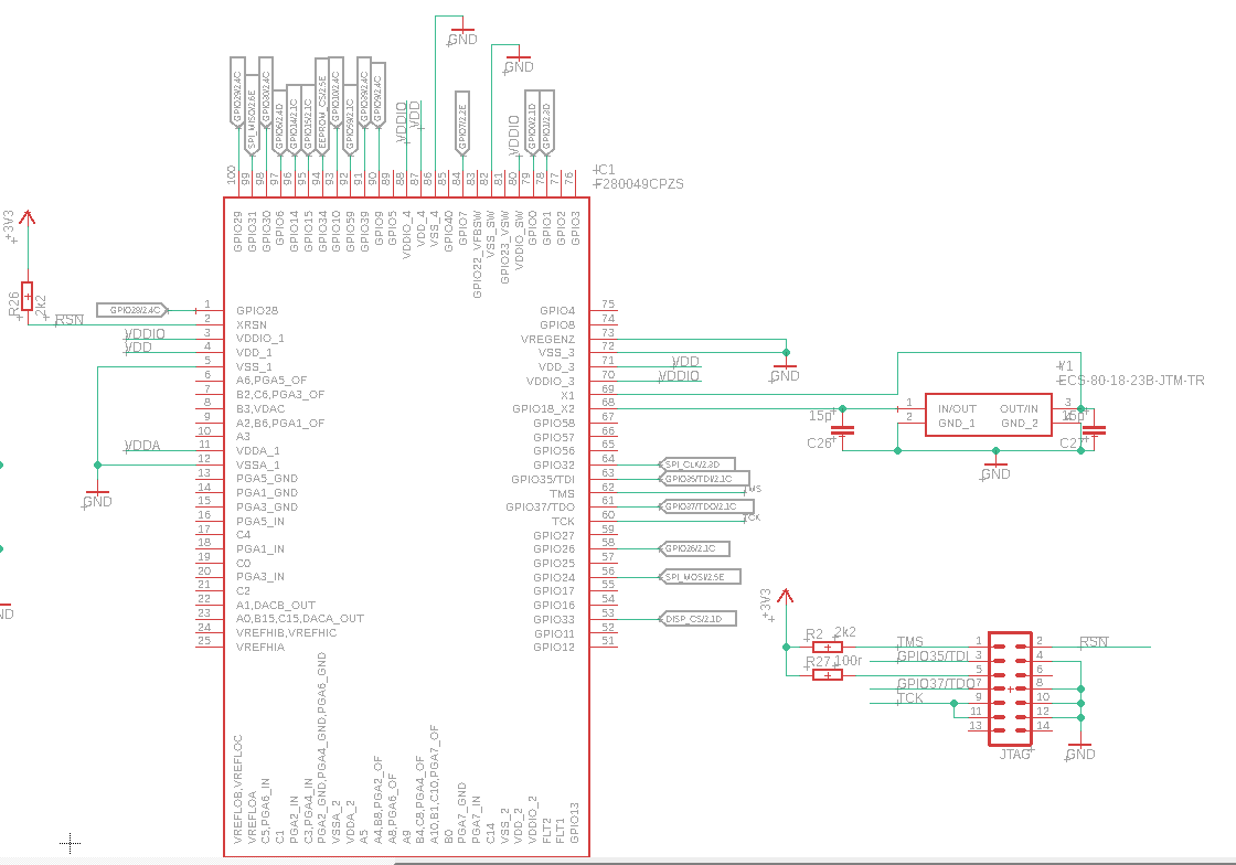

  • Its a custom design, processor schematic with jtag below, decoupling not shown.
  • David, A few points: 1. The XDS110 used on the launchpad is cJTAG. Is your design also using cJTAG? 2. This could be a power issue or clocking issue: i. Power issue in the sense that code loads fine but when you actually start running the application, there is a power spike from the device which dips the rails and causes the device to reset causing you to lose connection with the debug environment. Please check your design to make sure your power supplies are sized sufficiently. ii. Clocking issue in the sense that the clock input you are feeding from your custom design is higher than the launchpad and hence when run with the same settings, the device overclocks, code crashes and device resets. What is the frequency of the crystal you have on your design?

    The crystal and ciricuit are the same as the launchpad.
    Power supply
    3v3 rail regulator is rated for 1A and bypass caps as per the launchpad.
    5v rail is currently supplied from usb.

    I'll add that the crystal you are using is not what is used on the launchpad. The part number for the launchpad crystal is ECS-200-18-30B-AGN-TR which is not the same as the part you have on the schematic you posted.

    It definaly wont work with the a 8 meg 20pF crystal when its supposed to have a 20 meg 18 pF.
    Ill put the propper one on there and see what happens
