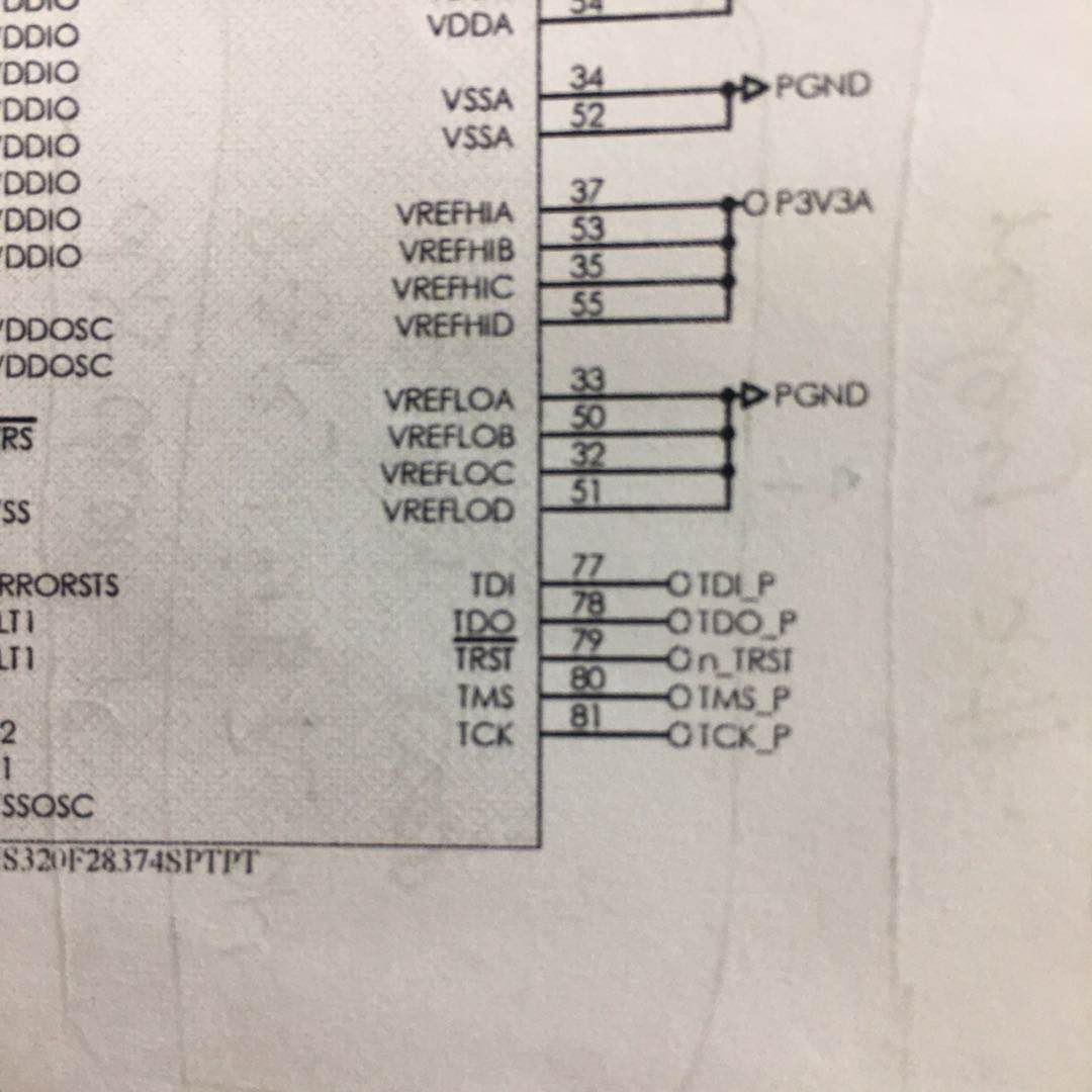

TMS320F28374S: JTAG port design review: Error connecting to the target: (Error -2131 @ 0x0)
Part Number: TMS320F28374S
Hi expert,
My customer made new board with F28374S and have problem with JTAG connection. Though I think the schematic have no issue, but I still need your help to have a look at it. (two board of two have the same issue)
The error message shows:
    (Error -2131 @ 0x0)
    Unable to access device register. Reset the device, and retry the operation. If
    error persists, confirm configuration, power-cycle the board, and/or try
    more reliable JTAG settings (e.g. lower TCLK).
The debugger log file shows:

-----[Perform the Integrity scan-test on the JTAG IR]------------------------
This test will use blocks of 64 32-bit words.
This test will be applied just once.
Do a test using 0xFFFFFFFF.
Scan tests: 1, skipped: 0, failed: 0
Do a test using 0x00000000.
Scan tests: 2, skipped: 0, failed: 0
Do a test using 0xFE03E0E2.
Test 3 Word 0: scanned out 0xFE03E0E2 and scanned in 0xFFFFFFFF.
Test 3 Word 1: scanned out 0xFE03E0E2 and scanned in 0xFFFFFFFF.
Test 3 Word 2: scanned out 0xFE03E0E2 and scanned in 0xFFFFFFFF.
Test 3 Word 3: scanned out 0xFE03E0E2 and scanned in 0xFFFFFFFF.
Test 3 Word 4: scanned out 0xFE03E0E2 and scanned in 0xFFFFFFFF.
Test 3 Word 5: scanned out 0xFE03E0E2 and scanned in 0xFFFFFFFF.
Test 3 Word 6: scanned out 0xFE03E0E2 and scanned in 0xFFFFFFFF.
Test 3 Word 7: scanned out 0xFE03E0E2 and scanned in 0xFFFFFFFF.
The details of the first 8 errors have been provided.
The utility will now report only the count of failed tests.
Scan tests: 3, skipped: 0, failed: 1
Do a test using 0x01FC1F1D.
Scan tests: 4, skipped: 0, failed: 2
Do a test using 0x5533CCAA.
Scan tests: 5, skipped: 0, failed: 3
Do a test using 0xAACC3355.
Scan tests: 6, skipped: 0, failed: 4
Some of the values were corrupted - 65.6 percent.
The JTAG IR Integrity scan-test has failed.

The schematic they have shown below:
