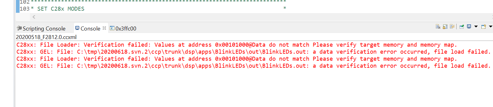

I've inherited a project, both the target hardware and the C28 firmware.  Part of the project is associated with NVSRAM (SIMTEK).  I've created the output file in CCS, and am trying to flash it in, but am getting a data verification error, as shown in the picture below

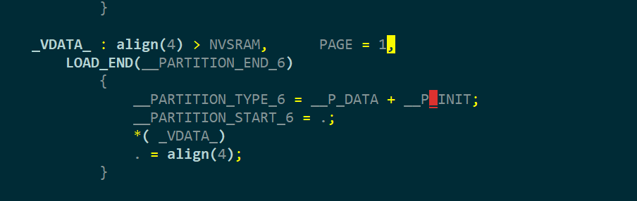

That address complained about, is the NVSRAM, as indicated in the project's associated .cmd file:
and:

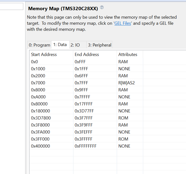

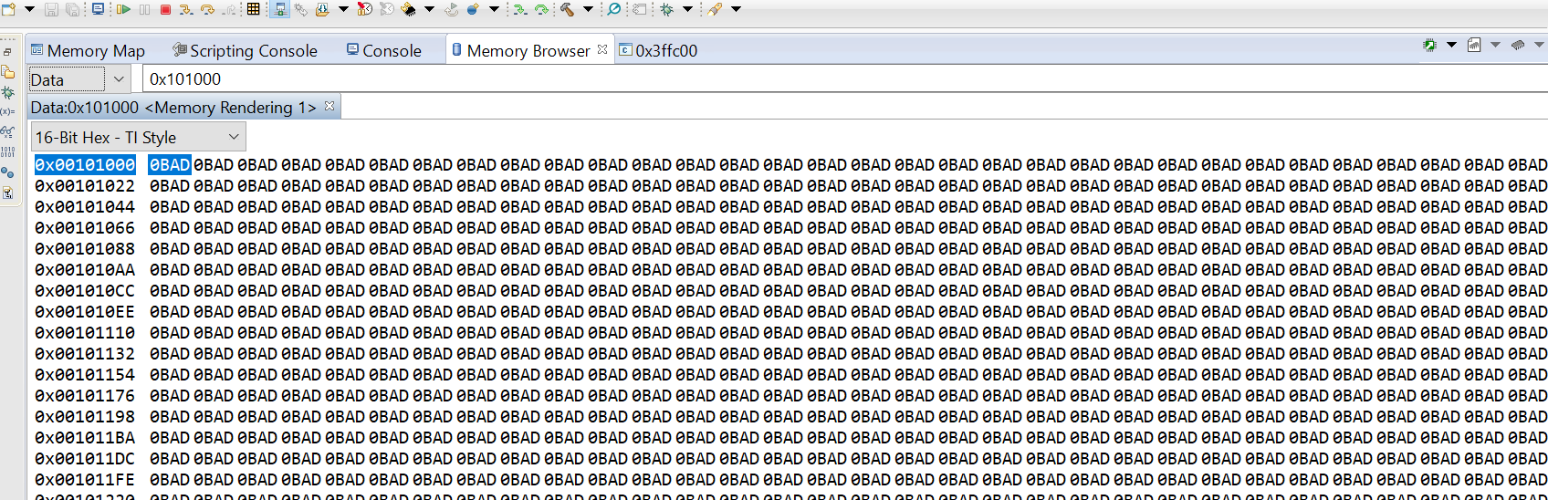

  • Additional info - the memory locations at that location are all "0BAD":
    and the memory map looks ok for read/write there too:
  • Robert,
    Is this for F2812?  The only place I saw a part number was in your target configuration name in the screen capture.
    I assume that you are trying to program an NVSRAM hooked up to XINTF.  Are you configuring XINTF prior to the load operation?  This is required for the XINTF to know how to interface with the external memory.  A GEL function is a good way to do this.
    -Tommy
