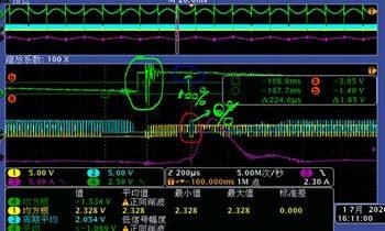

    I have an  issue of TMS32F280049C on a 6.6kw OBC project. The update of value in CMPA  (EPWM1)  is incorrect at line zero cross. CMPA is written by a value approximate 100%, but the duty of PWM from DSP output  is approximate 0%. the error is often incidental.
Here are a party of source code and waveform:
1:Waveform
The 4th Channel:  DAC output according to variable "PFC_Duty" .  It is correct in Red circle position.
The 1st Channel:  PWM output according to variable "PFC_Duty" .  It is incorrect in Red circle position.
The 2nd Channel:  PWM complementary output with 1st channel . It is incorrect in Red circle position.

    Hi Manish,
    as you said, I already did (please refer to the source code as below). In this switch period at Red circle position, the PWM should write CMPA equal to approximate 100% of period. in the waveform figure,the duty of PWM(Yellow channel) should be equal to approximate 100% , rather than 0%. in addition,The value of variable " PFC_Duty",  be written to the CMPA and DAC in two  switch periods differently. but the result is: the DAC output is correct, the PWM output is incorrect.
    Thank you for your support.

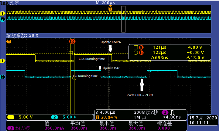

           For this issue,  It is seem that the shadow mode of CMPA(EPWM1) is unstable.  What do you think?. See details below:
           * Active Counter-Compare A (CMPA) load from Shadow on CTR= ZERO.
    • SOURCE CODE
      interrupt void ISR4(void)
          //Read from CMPA,and post to DAC
    DAC_Output_Val = HWREG(PFC_LEG1_PWM_BASE + HRPWM_O_CMPA)*0.0000152587890625*5;
    DAC_setShadowValue(DACA_BASE, DAC_Output_Val);
               __attribute__((interrupt))  void Cla1Task2 ( void )
    cla_temp =(uint32_t)(PFC_Duty*65536.0);
                 HWREG(PFC_LEG1_PWM_BASE + HRPWM_O_CMPA) = cla_temp;
                 cla_temp = (uint32_t)(PFCDB*65536.0);
                  HWREG(PFC_LEG1_PWM_BASE + HRPWM_O_DBREDHR) = cla_temp;
                  HWREG(PFC_LEG1_PWM_BASE + HRPWM_O_DBFEDHR) = cla_temp;
        * The timing of ISR4 and Cla1Task2
    * The waveform of DAC output and PWM output
