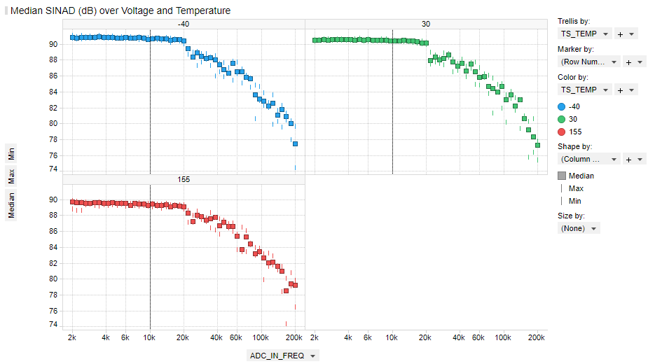

    Do you have any graph or detailed data for SNR and SINAD which you mentioned?
    Also, if you have temperature drift data, could you share me?

  • Hi Akashi-san,
    Attached is a some typical data for SINAD vs Fin for 16B differential mode across temperature for some F2838x devices.  F2838x has the same ADC as F2837x.
    I don't have any handy graphical data for ADC performance across VREF voltages, but the data in the DS is with VREFHI = 2.5V, which should be worst-case.

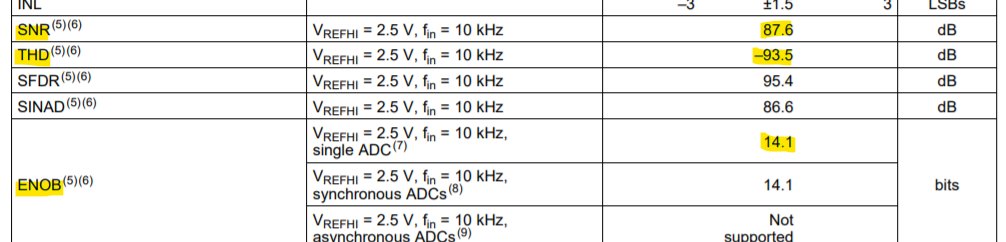

    From F28377D datasheet P106, SNR=87.6dB, THD=-93.5dB, ENOB=14.1bits as below.

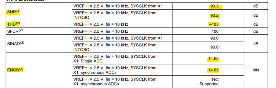

    From F28388D datasheet P136, SNR=90.2dB, THD=-105dB, ENOB=14.65bits as below.

  • Hi Akashi-San,
    The improvements in F2838x performance vs. F2837x are due to improvements in test setup noise and signal integrity.

  • Hi Akashi-san,
    We expect the same performance under the same the same conditions between these devices
