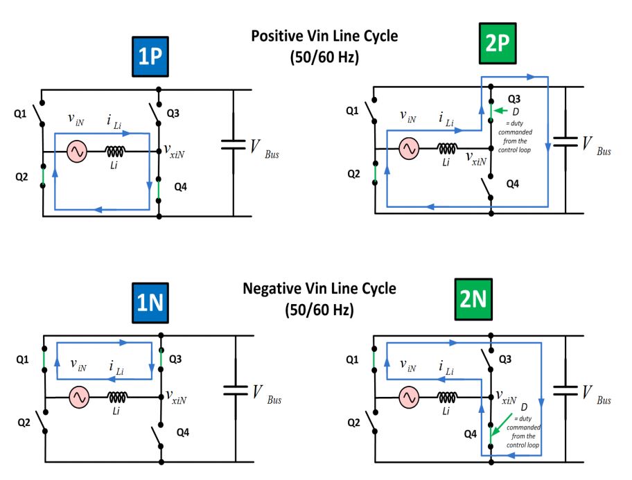

hi expert,
I see there is enable swap of high frequency PWM at negativeZeroCrossing3, which let PWMxA= PWMxB, PWMxB= PWMxA.
 if(acSine < threshold_NZC2)
                state_slew=0;
                pwm_SwState.enum_pwmSwState=pwmSwState_negativeZeroCrossing3;
                // Enable xA xB Swap
                ENABLE_SWAP_DEADBAND_OUTPUT(HIGH_FREQ_PWM1_BASE);
                ENABLE_SWAP_DEADBAND_OUTPUT(HIGH_FREQ_PWM2_BASE);
                ENABLE_SWAP_DEADBAND_OUTPUT(HIGH_FREQ_PWM3_BASE);
                softstart_duty=0;
                gi.i10=0;
                gi.i6=1;
                gi.Ki=0;
                gi_out=0;
And remain the setting, after that, disable the swap of high frequency PWM at positiveZeroCrossing3
 if(acSine > threshold_PZC2 )
                pwm_SwState.enum_pwmSwState=pwmSwState_positiveZeroCrossing3;
                state_slew=0;
                softstart_duty=0;
                // Dead band output swap disabled
                DISABLE_SWAP_DEADBAND_OUTPUT(HIGH_FREQ_PWM1_BASE);
                DISABLE_SWAP_DEADBAND_OUTPUT(HIGH_FREQ_PWM2_BASE);
                DISABLE_SWAP_DEADBAND_OUTPUT(HIGH_FREQ_PWM3_BASE);
                gi.i10=0;
                gi.i6=1;
                gi_out=0;
                gi.Ki=0;
I really don't understand, why you want to let PWMxA= PWMxB, PWMxB= PWMxA during the whole negativeHalf stage?
And basicly,
zerocrossing1 means shut down all the PWM channels
zerocrossing2 means giving the high frequency channels a fixed duty 0.004
zerocrossing3 means soft start of the high frequency channels, using state_slew_max to control the end of this stage.
