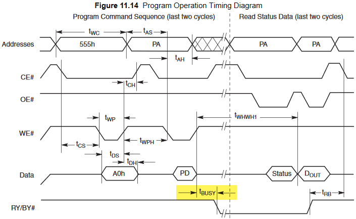

    One oddity that I am aware of is that the Flash RY/BY# signal takes a considerable amount of time (in EMIF terms) to become valid -- so the EMIF Extended Wait functionality may not work correctly if you configure the timings based on non-program operations. The flash example in C2000Ware handles this by polling on the RY/BY# signal using GPIO: ~\C2000Ware_XXXX\device_support\f2837xd\examples\cpu1\emif_dc_flash

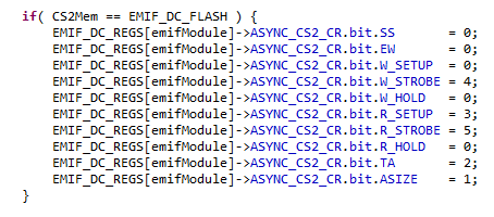

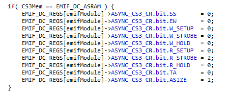

    I dont know if it help, but this is my MRAM and FLASH settings (emif on 100 MHz):
    MRAM
    FLASH
    Nothing stands out to me as being problematic.  You can also use the EMIF configuration tool in C2000Ware to double-check your settings: ~\C2000Ware_XXXX\boards\TIDesigns\F28379D_EMIF_DC\C2000-EMIF_ConfigurationTool.xlsx

  • Hello, I added some wait states when the flash chip/sector erasing. I added wait state also before MRAM write cycle. I hope it helps.
    #define FlashReadyStatus (GpioDataRegs.GPBDAT.bit.GPIO36) // Ready/Busy (Ready - 1 | Busy - 0)
    void lld_SectorEraseCmd
    FLASHDATA * base_addr,                   /* device base address in system */
    ADDRESS offset                           /* address offset from base address */
      /* Issue unlock sequence command */
      FLASH_WR(base_addr, LLD_UNLOCK_ADDR1, NOR_UNLOCK_DATA1);
      FLASH_WR(base_addr, LLD_UNLOCK_ADDR2, NOR_UNLOCK_DATA2);
      FLASH_WR(base_addr, LLD_UNLOCK_ADDR1, NOR_ERASE_SETUP_CMD);
      /* Write Sector Erase Command to Offset */
      FLASH_WR(base_addr, offset, NOR_SECTOR_ERASE_CMD);
      DELAY_US(1);
      while(FlashReadyStatus == 0); //Wait for Ready

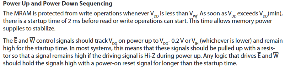

  • Marek,
    Your signal levels look ok.  At this point, I recommend a deeper dive into the MRAM requirements to see if some condition is being violated.
    For example, I noticed a power-up sequence in the MRAM datasheet that might need some attention:
    Maybe the MRAM is experiencing a dirty reset that would lead to unpredictable behavior.
    -Tommy
  • Tommy, thanks for advices. I soldered pull up resistors for E, W also for CS2, CS3 pins.I coded protection for memories with multiple state flags, so there are no possibility to write at once to flash or mram. Now, im going to burn program to processor and I will see if it helped. I will announce the result to this thread.
