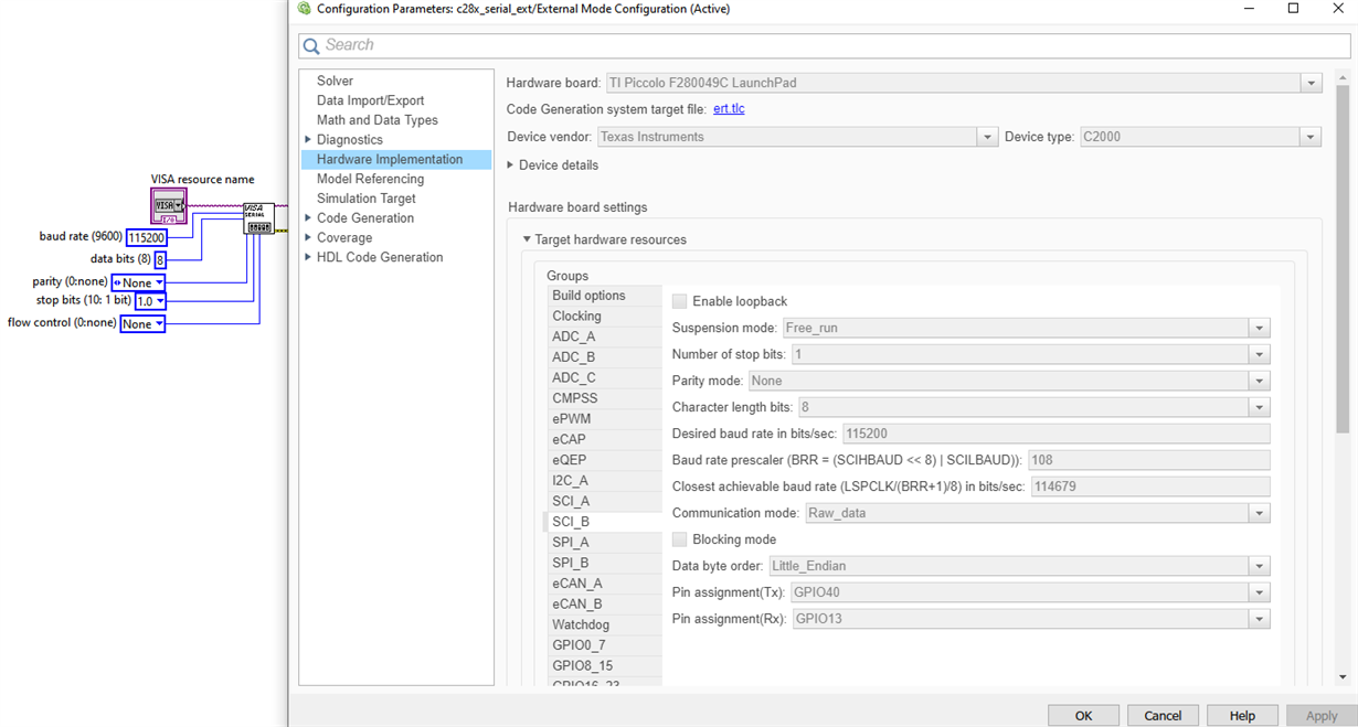

I am setting up a communication link between a Pc app and the LAUNCHXL-F280049C. I am using an external FTDI chip USB to serial converter to connect the SCI_B Rx and Tx lines from target.
The Tx works fine I am receiving the data I am sending from the target.However I am encountering a strange issue on the Rx sid: while in external mode ( which uses SCI-A ) I am trying to display 4 bytes of data sent from the PC App on SCI_B
If I send "1234", I receive "1020". there are always zeros between the bytes received and I have no clue where it is coming from. I uploaded an image showing the data being captured on the logic analyzer.

  • Hello Vince,
    I don't think the SCI config is the problem here.
    you said "In particular, the max number of data bits is 8, while the data length of the PC config shown is 10", do you mean the "data Length" is set to 10 or did you use the Logic analyzer screenshot to determine that ?
    here is the test I just did:
    1. make sure the UART configuration is the same for the host and target ( from the simulink Hardware implementation window )

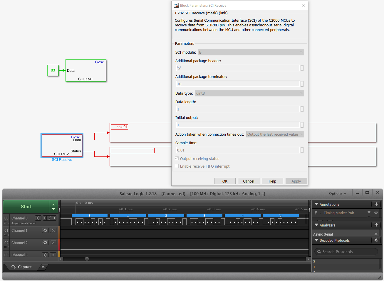

    on the SCI_B Rx Block, I changed the data type to uint_32 and the data length to 1:
    Now, when sending Header ('S') + 4bytes + termination (\n), I am receiving the correct 4 bytes at the output of the Rx Block : the equivalent ASCII hex for the 4 bytes I sent.
    However,
    if I set the Data length to 1 with a unit_8 type in the  SCI receive block diagram, I do not receive anything :
    Finally, If I set the data length to 4 with a uint_8 type, I receive the zeros between the different bytes:

    I think I see the confusion happening. First I will say that I cannot really help in debugging Simulink, as it is not a TI system and therefore not something I can really assist with (or know well enough to debug). I will say however, that I do understand what you are trying to do a bit more, and see what the config window from the first image is actually showing.
    If I understand the image correctly, the data length is actually talking about the number of bytes, not the length of the data bits portion of a single byte.
    Given this, this really does seem like it is more of a mismatch on the number of bytes in a given "packet" that Simulink is configuring. Meaning you are trying to send from the PC Simulink app 4 total data bytes ("1234") of 32 bit data (you are actually using 32 bit data it appears), but were setting the "data length" to 10 bytes. Unfortunately, I do not know what Simulink does when it receives less data to send than it is expecting, but this could be the cause of the issue you were seeing (where it may be just 0-filling the gaps).
