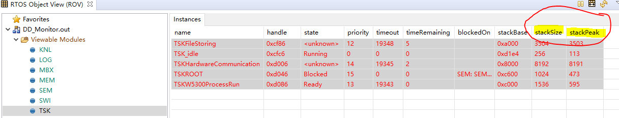

    Does stack overflow mean that every task exceeds the stack size(MAUs),like the red circle in the picture below:
    How do we know whether it exceed?

  • BIOS version: 5.42.1.09.
    XDCtools version :3.24.05.48
    The ROV does not include BIOS,but includes TSK which can help view status of each task.When I stopped my project,clicked TSK,it showed many info,
    such as stackPeak,stackBase,stackSize.
    When displayed stackPeak bigger than stackSize , is it mean stack overflow?
    In addtion,there is a task,I set stackSize = 2048.The program has just been burned in the DSP, but it has not yet started running.Its stackPeak showed 2047; When I click the run button, and after running for a while,I stoped ,but it also showed 2047.When I modified stackSize to 4096,it showed 4097 forever.Is it normal?There are five tasks in my project, there are two tasks are in this situation.
    What's more,the stackPeak of other three task is always smaller than its stackSize. When I have other operations, the stackPeak of this task will change.
    Best regards!
    Minty

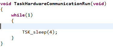

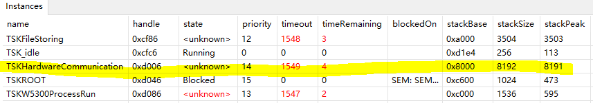

  • Hi
    Now I have the following problem:
    ①My ccs has ROV,but BIOS is not included. (BIOS version: 5.42.1.09. XDCtools version :3.24.05.48)
    ②The ROV does not include BIOS,but includes TSK which can help view status of each task.When I stopped my project,clicked TSK,it showed many info,such as stackPeak,stackBase,stackSize.
    ③There are five tasks in my project,and two of them are quite special. The details are as follows:
        When I modified stackSize to 8192,it showed 8191 forever.
        When I delete all functions in this task, that is to say, it is an empty task, but it still showed 8191.
        Is this phenomenon normal?
    Best regards!
    Minty

  • There is no BIOS for in ROV/KOV for DSP/BIOS.
    If you increased the task stacks and it is still be blown, you might want to look at what is right before it memory. Could you get writing past that memory and it corrupting the top of the stack.
    Todd
