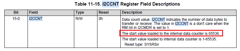

So i've got my i2c driver 99% functional but i've stumbled over a problem that is bugging me.
It appears to me that in order to issue repeated starts to a bus, repeat mode has to be on.  I've done a fair amount of testing and no matter what I try, if repeat mode isn't on setting the start bit doesn't generate a repeated start even when we've finished everything we were doing previously.  That's fine, I can live with that.  What I can't live with is erroneous documentation.
Page 2257 of the TRM:
*Ahem...* "Only applicable when the I2C module is a master transmitter".  That is 100% incorrect as far as I can tell.  Setting the RM bit when in master receive, allows a repeated start to be generated on the bus.  If I don't have RM set, I cannot generate a new start while I have control of the bus.  Would you disagree with my above assertion?
Another thing.... The TRM discusses what a repeated start is in section 25.3.5.4 but never really tells the user how to do it.  If my observations that it is only allowed when RM is set are correct, this should be explicitly spelled out in the TRM.  The documentation for the RM bit make it seem like its behavior is only tied to the CNT register and repeated data transmission.
OOOoookkkkk.....now that brings me to the main point of this post.  Assuming my observations are accurate and I'm not doing something dumb in my software, the above raises a small but IMO significant issue.  How do I clock in an accurate number of bytes?  Let's run through an example:
  1. Ack poll the slave - Setup master transmit repeat mode, send a start condition, look for the ADRY bit to be set, test the nack bit to determine if slave is ready
  2. Setup slave read address - Setup master transmit repeat mode, send a repeated start condition, send the address in the memory of the slave device (eeprom), interrupt on ARDY
  3. Read slave data - Configure master receive repeat mode, send a repeated start condition, interrupt on the RXFF, copy data in, when I've read all the bytes requested by the higher level application, send a stop condition
In the above case, because I'm sending the stop in software I don't have deterministic control of the number of bytes that are shifted in.  My two choices are to send it after I've received the last requested byte which results in at least one additional unwanted data byte being shifted in.  Alternatively, I can try to send the stop at n-1 and hope the timing is right that I get my last byte in before stop is sent.
Ultimately I guess my point is the peripheral should be able to send repeated starts when not in repeat mode.  This would allow me to use the count register to shift in an accurate amount of data.  So am I crazy?  Have you ever been able to send a repeated start when RM isn't set?

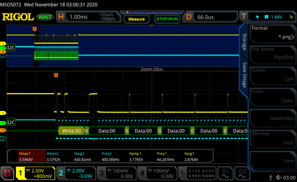

  • Trey,
    It is good to hear from you. Hope you're doing great.
    Repeated Start can be generated in both repeat mode and non-repeat mode. Please check below example.

  • The problem is repeated start isn't sent in some cases.  You brought up a good point about underflow, but that still doesn't make a difference.
    For this test/observation, I moved the transmit buffer writes for the eeprom memory address (not the slave address) before I set the start bit in MDR.  This should prevent the underflow condition.  See below:
    I2C_setSlaveAddress(I2CA_BASE, 0x51);
    // Send start as master transmitter
    I2C_setConfig(I2CA_BASE, I2C_MASTER_SEND_MODE);// | I2C_REPEAT_MODE);
    I2C_setDataCount(I2CA_BASE, (currentMsg.numBytes*2) + 2);
    // Setup data to send
    I2C_putData(I2CA_BASE, currentMsg.memoryHighAddr);
    I2C_putData(I2CA_BASE, currentMsg.memoryLowAddr);
    //Start condition sent here
    All of the above happens immediately after the ack poll code I posted previously.  Based on what you've said, a repeated start condition should be generated in this case, but it is not.
    The Write 0x50 is the ack poll which is succeeding.  Then to illustrate my point, I've changed the desired slave address to 0x51 (doesn't exist on the bus).  If your assertions about the repeated start are correct, I should see a repeated start (and subsequent NACK) on the bus, but I do not.
    Does that better illustrate the problem?
    Trey

    I think I have figured out the problem.
    In non-repeat mode, when I2CCNT = 0: it actually means number of bytes to transmit is 65536 before it generates the STOP condition. I tried this out on silicon and it is true. We have documented this vaguely in register bit-field description. I will make sure to clean this up in future TRMs.
    So, I2C state machine doesn't allow you generate another START condition until 65536 bytes are sent.
    Manoj
  • Manoj,
    Good point.  I had not seen that in the CNT register.  However, I don't think that explains this behavior.  In the above example with the scope capture, I am setting the CNT register to a reasonable value after I have turned off repeat mode... so shouldn't a repeated start be allowed?
    Trey
  • Trey,
     What actually ends up happening is the data is sent out as expected but the slave address isn't.  To illustrated this, I changed the slave address to 0x51 (doesn't exist on the bus) and the transfer still occurs because it relies on the address done during the ack poll.  This is why I was originally saying repeated starts aren't allowed unless repeat mode is turned on.
    In your earlier post, you had mentioned the above quote. I believe this condition is happening because of the following reason:
    I2CCNT = 0 (Number of bytes to be transferred is 65536)
    1st START condition generated.
    Now, I2C state machine will expect 65536 bytes to be transmitted. In your case you transmit only SLAVE address and then move on to below code.
    2nd START condition generated (STT = 1)
    Now, since the 1st START condition is incomplete (state machine expecting 65536 byte transfer), 2nd START condition doesn't get generated. Even though you set I2CCNT to some non-zero value it takes into effect only for second START condition.
    So, the bottom line is in non-repeat mode, you can't transfer zero byte. Minimum byte that needs to be transferred is 1 byte.
    Manoj
