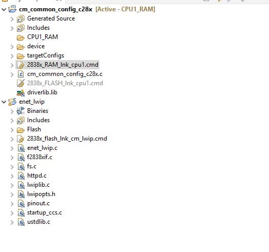

  • Dear Yashwant,
    Now I am trying to add the pinmux configuration function in the enet_lwip.c file by myself.
    I am trying to realize the pinmux configuration and lwip on one single project.
    Is it reasonable?
    So according to your advice, C28 CPU1 is responsible for pinmux configuration, and Arm Cortex-M4 is responsible for the lwip.
    So there are supposed to be two projects in my CCS workspace as the attached screenshot, right?
    But how to burn the two projects' bin files into one F28388 chip (non-volatile)?
    Thanks!
    zhou ping
  • Zhou,
    The C28x CPU1 core is the master core. The pin mux configuration can be done only through CPU1 and not the CM.  Please go through f28388x TRM to understand more about the core capabilities.
    Yes you need to have 2 projects in the CCS. 1 that generates the binary for CPU1 and the other for CM.
    To run lwip on CM4, you will have to first load and run binary of the project : cm_common_config_c28x on the C28 CPU1 core by selecting it in the TMS320F28388D.ccxml debug session and then load and run CM4 project : enet_lwip on to the CM core.
    Yashwant
  • Dear Yashwant,
    Thanks very much for the valuable suggestions.
    I have established two CCS projects, one runs on CPU1 RAM, the other run on CM flash.
    And the lwip protocol works well when I use emulator XDS100V2 to run the two projects in debug mode.
    BUT when I switch the CPU1 project to CPU1 FLASH, and the other is still on CM flash.
    The LWIP does not work after both CPU1 flash and CM flash have been burned !!
    Why?
    Could you please give some clues?
    Please see the attached screenshot.
    2838x_FLASH_lnk_cpu1.cmd and 2838x_falsh_lnk_cm_lwip.cmd were used.
    Thanks!
    zhou ping
