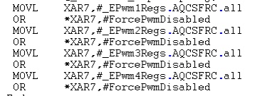

I'm able to turn off PWM through the code below:
But then when I try to turn on the PWM with code below, it doesn't work
Anything wrong with the code?
Thanks.

The value of ForcePwmDisabled is zero, and therefore the OR *XAR7,#ForcePwmDisabled instructions won't modify the AQCSFRC registers. I.e. a bit-wise OR of a literal zero doesn't change any bits.Howard Zou said:But then when I try to turn on the PWM with code below, it doesn't work
Based upon the posted code assume that both the CSFB and CSFA fields in the AQCSFRC registers, in which case shouldn't the OR instructions be move instructions instead?
