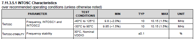

The customer wants to use TMS320F280025 in 100℃. But too high temperature will cause clock frequency distortion of MCU.
Please help them to Correction internal oscillator.

Hi Susan,
Can you let me know what is the customer's frequency target for the internal oscillator frequency at 100℃? Please also note that there is a datasheet spec change improvement on the INTOSC characteristics in rev B that tightened the range at high temperature.

The target frequency is 100Mhz, but if there is +-3%, it will fall between 103Mhz ~ 97Mhz.
Hi Susan,
The updated F280025 datasheet has tightened limits for the internal oscillator:
Let me know if this still does not meet customer requirements at the intended temperature. If you have additional details on the specific application and requirements that customer needs for the internal oscillator, please send these through my email.
