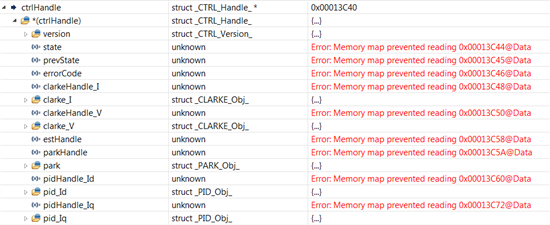

    I would like to do the same, I mean, e.g.:
    Start with a regulated current at 6A and then switch to 3A or start with 3A and then boost the current to 6A.
    A good way to do that seems to modify the limit of the PID speed regulator with the functions "PID_setGains", "PID_setUI", "PID_setMinMax" and "CTRL_setGains" but it seems to not work.
    As you can see in the picture, I can't see the structure of the PID speed regulator and I don't know why.
    Thanks for your help.
  • This is for an F2806x device?
    Try adding to your expressions view
    controller_obj
    or
    controller_obj*

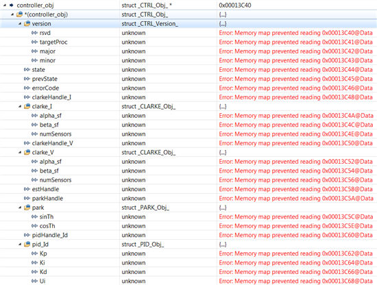

  • Hello Chris,
    Yes, it's for a F2806x device.
    I see the same problem with controller_obj in the expression view.
  • Can you expand the structures?
    You are connected to a powered target, running a valid .out, with real-time enabked?

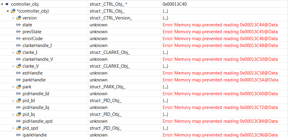

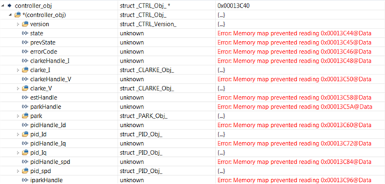

  • Hello Chris,
    This is the structures expanded :
    The version of the controller:
    Yes, my target is powered, running with a valid .out  and real-time is enabled.

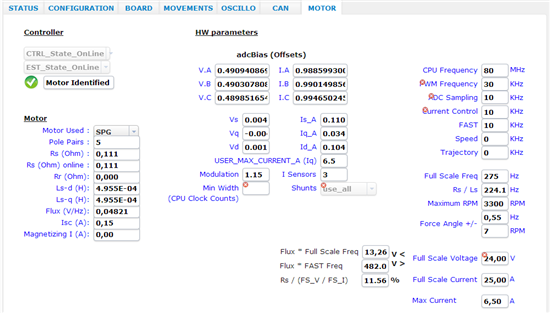

  • I don't have an answer for what is happening. Did you link in a different memory map .cmd file or something?
    It appears like everythign is running well, yes?
    minor thing, but why did you reduce the CPU frequency to 80 MHz from 90?
    also, your Isc variable has a scaling issue in the display, it needs to be multiplied by 100, the calculation should give you 15A.
  • Hello Chris,
    No, nothing special about memory map .cmd file.
    Yes, everything is running well.
    When I added my CAN stack in that MCU, I think I read that the maximum CPU frequency allowed for the CAN bus at 1 Mbps is 80MHz.
    About Isc variable, I checked the binding variable and :
    with ((gMotorVars.Flux_VpHz  / 6.28) / gMotorVars.Lsd_H) the result is 0.14. It seemes that 6.28 correspond to 628.
    with ((gMotorVars.Flux_VpHz  / 6,28) / gMotorVars.Lsd_H) the result is 14.65. It seemes that 6,28 correspond to 6.28.
    Could you confirm, please?
    This looks like an issue of Windows european style comma vs. decimal point.  You should use the ,
