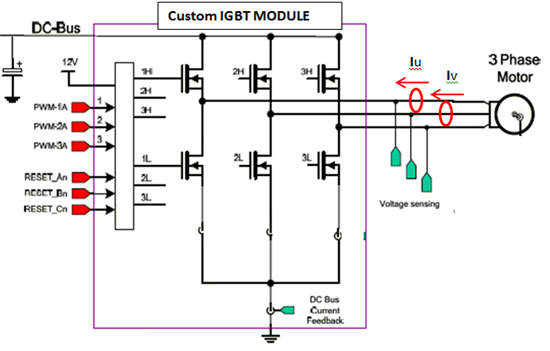

    thanks for your response. I cannot seem to figure out what I’m doing wrong with the InstaSPIN. We have developed an interface between proven IGBT high power stage and your ControlCard F28069MISO. It is based on TI hvkit. Three voltages are sampled, with a divider to 30V for 3.3V input and pole of 663Hz (just to be safe, we thought that our motor might require high PWM frequencies).
    As a current sense, we use two +-200A LEM current sensors on phases U and V, scaled to be centered around 1.65V, max voltage 3.3V. Polarity shown by red arrows, no inverting amp before sampling. To do the initial (safe) testing, LEM sensors have 10 turns on them, so the user.h is set to 52.8A (calculated to be a current range from 0 to 3.3V). Final design counts with much higher voltages and currents, but for development, everything (including used motor) is scaled down.
    All used projects are for hvkit, with modified files for our hardware. Using Lab1 and debugger, I can confirm reading all three stable voltages in expected magnitude. The same goes for two current sensors, they are mapped correctly (shortening U motor wire to the ground gives 0V on U voltage and expected current on Iu. The same goes for Uv/Iv pair. DC bus compensation turned off as suggested in one of the previous posts (in ISR before calling the controller).

    What was another problem is the fact that our IGBT module have only three inputs - one for each phase, and a global disable (opens all IGBTs, high Z). I added this global disable on/off into DRV_enablePwm and DRV_disablePwm functions. Is that enough? Or does InstaSPIN require having high Z on just one set of transistors in some moment? We cannot control them separately like that.

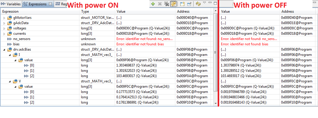

  • Let's look at the bias. Please add this to your watch window:
    drv.adcBias
    and when Rs is being identify, halt execution and send me the values you get on drv.adcBias (the entire structure of seven IQ24 values.
    Also, maybe you already checked this, but please confirm that you updated the filter pole (663 Hz?) to this define:
    #define USER_VOLTAGE_FILTER_POLE_Hz  (663.0)
    -Jorge
  • Thanks,
    So I made two pictures, on the left with a power supply on, one on the right with a power supply off. It is clearly visible that there is quite a difference between them. I confirm the pole location in user.h

  • Doing a few calculations, based on section 6.5.2 of SPRUHJ1C, I calculate a Vbus of:
    Voltage_bias = 0.176
    USER_ADC_FULL_SCALE_VOLTAGE_V = 30.189
    USER_IQ_FULL_SCALE_VOLTAGE_V = 90.567
    USER_VOLTAGE_SF = USER_ADC_FULL_SCALE_VOLTAGE_V/USER_IQ_FULL_SCALE_VOLTAGE_V = 0.333
    Vbus = 2 * Voltage_bias * USER_ADC_FULL_SCALE_VOLTAGE_V / USER_VOLTAGE_SF
    Vbus = 31.8796
    This Vbus is higher than the measurable range by the ADC, which is 30.189.
    Could you confirm you have a Vbus that's measurable by the ADC?
    Could you confirm that during the offsets measurements (CTRL_State_OffLine) you have 50% duty cycles going to the motor windings? This would confirm that the inverter is ON, and that the driver stage doesn't modity the duty cycles in any way
    Bottom line, you shouldn't measure all negative values in the voltages, but you should measure values around zero, AC values.
    -Jorge
  • Thank you, Jorge.
    I added the DC bus sensor - as I mentioned before, my system does not contain DC bus measurement. Well, now it does.
    Using your calculations, I confirm that voltage offsets corresponds to the Vbus. Now I'm using voltages 20-30V , and all offsets scale accordingly. I had no idea it is centered like that! Being named as offsets, I suspected them to be an ADC offset with transistors grounded. That cost me quite some time, trying to figure out why my system is not measuring near-zero offset values. Now when you say that those are offsets related to the Vbus, it makes sense.
    I fixed my user.h file to be more close to the reality (IQ scaling)
    Yes, inverter has 50% duty cycle during offset calc.

  • Okay, I think I'm onto something. Those U,V,W phase voltages (sampled and with an offset) are indeed negative during the Rs calculation, and that causes Rs being close to 0 Ohm. The problem is, that the calibration will be done over 50% duty cycle with no current, making offset ~ 14.9V on each phase. But when the current starts flowing, voltage drops somewhere (I'm using a 40kW IGBT module). This drop would probably be too small to be noticed on ~500V DC supply, but since I'm using 30V supply, this drop creates approx. -0.5V on the phase voltage (with offset subtracted already). This would result in Rs=(-0.5V / 2A), which is of course nonsense.
    Now, how to compensate for such a drop? Obviously even when using an identified motor, the system will think it is spinning opposite direction, because thanks to the voltage drop, the phase voltage always seems to be negative.
    I tried to test this by taking one (similar) hobby motor with parameters from your user.h, and run it as mine motor. The loop was unstable, and when spinning, the system always estimated that the direction is opposite from desired.
  • Yes this is interesting, so please confirm, are you using high voltage high current IGBTs to control a low voltage motor? This might be an issue, just like you are seeing in your tests, the voltage drop in the high voltage IGBT and the switching speed of the IGBT might not be the best hardware for a low voltage motor.
    Is it possible for you to test our standard 8301 board to test your motor first?
    Not sure how to compensate for this if this is the issue. It makes sense though, that if you measure voltage offsets without current, and then while conducting current the IGBT has a big voltage drop, that will shift your offsets, but most importantly, the offsets will be changing from phase to phase, depending on current flowing through each IGBT.
    So what I suggest is for you to try our DRV8301 board to confirm this is the issue, and secondly, if you can select a power stage that matches your motor. If your switching frequency is high (especially if you have a low inductance motor) you might be better off with MOSFETs instead of IGBTs.

  • By the way, here are a few diagrams that might help on the current polarity question:
  • Yes, very illustrative. Thank you! It would be a good addition to the "designing your own system" chapter in the documentation.
