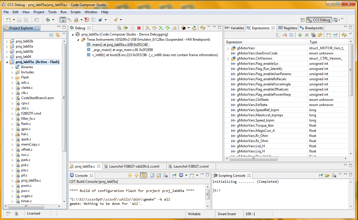

    Well when I build the program Lab5a, I get the following:
    C28xx: Loader: One or more sections of your program falls into a memory region that is not writable.  These regions will not actually be written to the target.  Check your linker configuration and/or memory map.
    When I try to debug, the evm never programs. I have gone into properties of the project and tried to change the device type, but even doing that the board never programs. And when I select .. Piccolo F28027 there is an error about not enough memory for the program.
    So this thing does not program per the instructions, which I have followed to the tee. I even started back on Lab1 and followed the directions starting from there, but the same thing. There appears to be a step, or two, that is missing in the instructions.

  • Hi Brad,
    1. Please confirm that your LaunchPad has the InstaSPIN FOC logo on the PCB
    2. Please confirm that you have removed the three jumpers JP1, JP2, JP3
    3. Please confirm that BoosterPack is installed in correct orientation (A,B,C phase connections on same side as USB connection) and you are providing 6-24V at PVDD and GND?
    4. Please confirm you have created a valid Target Configuration File as in this picture, or are pointing to the one provided in MotorWare: C:\ti\motorware\motorware_1_01_00_12\sw\ide\ccs\ccs5\targetConfigs\TMS320F28027_xds100v2.ccxml
    5. While in the CCS Edit Perspective, right click this target confit and Launch the configuration
    6. You will now be in the CCS Debug Perspective.  Click on Run --> Connect Target
    7. Select Run --> Load --> Load Program and select your .out  (mine is grey'd out because I do not have HW connected right now)
    8. This will flash the LaunchPad with your binary
    9. You can then click Run --> Resume and enable Real-time
    10. Instrument the project using View --> Expressions (you can load this expressions view by using View --> Scripting Console and selecting the matching proj_lab05a.js file) or by importing the Universal GUI by View --> GUI Composer --> Import, and pointing to a .zip of C:\ti\guicomposer\webapps\InstaSPIN_F2802xF_UNIVERSAL
    At which step do you have trouble?

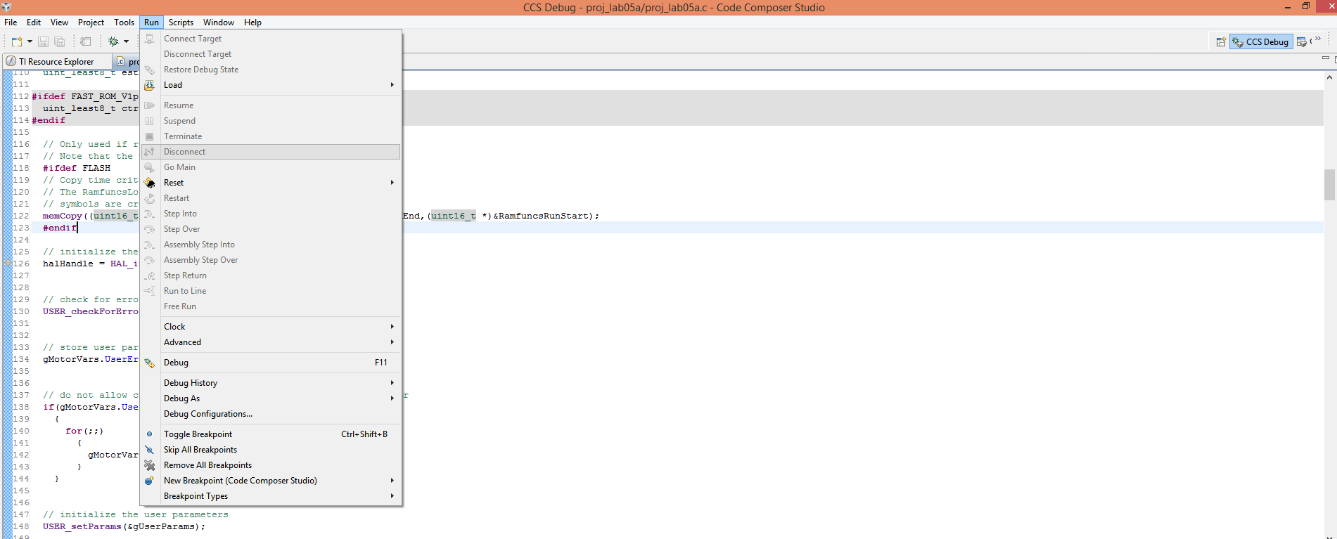

    I do not have the "Launch Selected Configuration" in my menu though! (See screen shot)
    Nor do I have the other items that you show in your post. This is the first time I am working with CCS, as I usually use Keil so this is a completely different way to run things than Kiel does things.
  • In your first image you are trying to Launch the Configuration from your Project.  Per my instruction you need to go to
    View --> Target Configurations
    and Launch from there:
    For your second image note that you ware in the "CCS" Edit Perspective because you have not launched a debug session.  Per my instruction click on "CCS Debug" to switch to the Debug Perspective where you can connect the debugger to the target and load your coade.
    The CCS Debug and CCS Edit buttons should be at the top of a tab, usually in the right hand corner. You can see them in my image in this post.

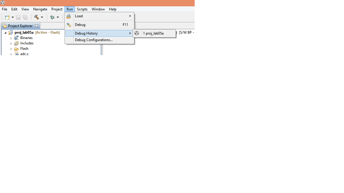

    However, even after launching the configuration when I go to the run there is no Connect enabled, and yes I am in the CCS Debug mode (see below).
    Luanch:
  • Hello Brad,
    Can you try these steps below:
    If it is success, it will enter the debug session and load the program:

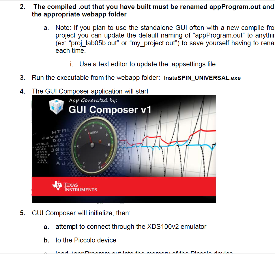

    4. Connect and load in CCS, or copy the .out to the \guicomposer\ folder, rename to appProgram.out, and launch the .exe
    Yes, we offer a GUI to instrument ANY MotorWare project.  But you first have to build a project specifically for your type of motor.  This is because our same software solution works for tiny little high speed motors up to huge high voltage motors.  You have to tell the software which type you are using.

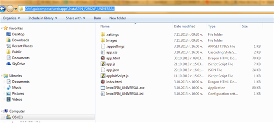

  • to offer one more olive branch, tell me everything you know about your motor and I will build an appProgram.out for you that you can place at
    C:\ti\guicomposer\webapps\InstaSPIN_F2802xF_UNIVERSAL\
    and then just run InstaSPIN_UNIVERSAL.exe

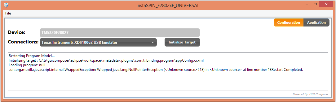

    3) copied over the *.out file (renamed to appProgram.out) to "C:\ti\guicomposer\webapps\InstaSPIN_F2802xF_UNIVERSAL" then launched InstaSPIN_UNIVERSAL. All I get is the following.
    This is what the instructions say it should do.
    Nothing even close!
    This is why my frustration with this project is so high! Even when I remove, re-install, try from scratch (PER BATUM) follow the the instructions line for line the tools still do not do what the instructions say they should.
    Here is what is in my "default" .appsettings file.
    {"default": {
        "connection": "Texas Instruments XDS100v2 USB Emulator",
        "deviceFilter": "",
        "program": "appProgram.out",
        "device": "TMS320F28027",
        "connectionFilter": ""
    This is after another uninstall and install of the guicoposer.exe.
    Board is connected via USB, with 14V applied to the Boostxl board, and the motor connected.

  • Well, not connecting is a different issue.  There isn't a reason you shouldn't be able to connect.
    1. Jumpers removed from LAUNCHXL-F28027F
    2. LaunchPad Boot mode switches in correct settings: ON-ON-ON
    3. BoosterPack connected with proper orientation (all connectors on boosterpack should be on same side as USB of LaunchPad)
    4. 6-24V at BoosterPack PWR-GND pins
    5. USB connected to PC.  PC should "find hardware and install drivers". You can check under Windows Device Manger to make sure that it is finding Texas Instruments XDS100.

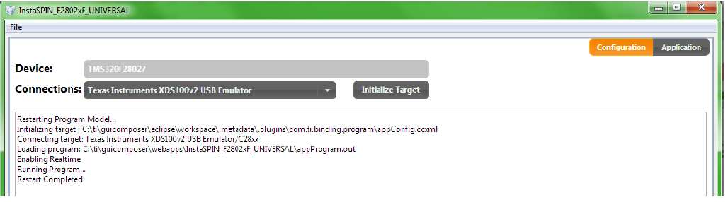

    Attached is the appProgram.out I built for you.
    http://e2e.ti.com/cfs-file.ashx/__key/communityserver-discussions-components-files/902/6354.appProgram.out
    screenshot of the GUI Composer .exe successfully launched
    and then the application
    This project will only help to ID the parameters.  You can NOT run the motor with this project.

    If we get good values you can then run proj_lab05a in torque mode to see how the core sensorless FOC torque mode performs.
  • OK, progress......
    I was able to launch using your file and ran your out file.
    Here are the values it gave.
    RS = 0.0043
    LS = 0.3242
    Flux = 0.0049
  • Well, the Ls value certainly isn't valid. This give an Rs / Ls (H, the display is mH) = 13.27 Hz.  You should be expecting something > 2 kHz, and likely much higher. That would require about 2uH.
    I've very surprised the Rs is so low.  I expected it to be a factor of 10 higher.
    Did the motor spin the entire time from EST_STATE_RampUp until it completed?
  • The motor did NOT spin at all. I could hear the PWMs pumping trying to work, and thought this was part of the program means to calculate the values you wanted.
  • Brad,
    I can't find a true spec on the motor that tells me the current, but I found another page that is selling a 120A continuous controller to go with it....so this motor may be out of the range of a 10A BoosterPack. However, unloaded (no prop) you should still be able to ID and then run.
    in attached I upped the RES_CURRENT to 3.0
    Please let me know if it starts spinning during the RampUp state of estimation. If it doesn't, try giving it a little spin with your fingers to overcome the cogging torque.
    If it does, please note if it spins for the next ~1.5 minutes til RampDown, or if it ends early note at which EST_STATE it stops.
    BTW - you've chosen about the hardest motor possible for a sensorless FOC technique. Congrratulations?
    appProgram.out
  • This time the motor made a bunch of noise, but would not turn even with me trying to spin it manually.
    Unfortunately it just works out that way. This is a motor that I need for the torque capability and the speed.
  • Brad,
    Give this a try, it's proj_lab5a (Torque mode, no speed controller) which I built with the following params:
    #define USER_MOTOR_Rs                   (0.0043)  // ID'd
    #define USER_MOTOR_Ls_d                 (0.000002)  // guess to hit Hz
    #define USER_MOTOR_Ls_q                 (0.000002)  // guess to hit Hz
    #define USER_MOTOR_RATED_FLUX           (0.0049)  // ID'd
    Make sure you have all the blue boxes checked, then click Run.
    The Resistance will recalibrate for about 8 seconds, then it will go into:
    You can now enter a Torque command, in Amps.
    Note that this Iq_ref_A does NOT have a limit.  If you put in 100 it will set 100 as the Iq_Ref input to the PI controller. If your motor had a load I'm sure it could take more than the 10A that the BOOSTXL can supply, and you would dame the board.
    See if your motor runs....
    If these are actually the params of your motor (2uH), this is going to be extremely challenging for a current control based motor control solution. If you MUST use this motor you will probably find it easier to use an ESC specially designed for this motor. They typically do current limiting (not control) through a comparator threshold and they vary the duty to the motor by varying the Vbus.  It is very different from what we in the industry (not just TI) do with Field Oriented Control.  Hobby motors are a different breed...they have been completely "mis-designed" (ridiculously low Ls) for these archaic control techniques.  The motor could be made cheaper and actually give better performance if they were designed like "normal" motors....which some of our customers are now doing.
    BTW - why do have to use an off the shelf hobby motor? There are plenty of other motors that can produce torque you require.  A hobby motor is about the worst motor you could choose to work with!
