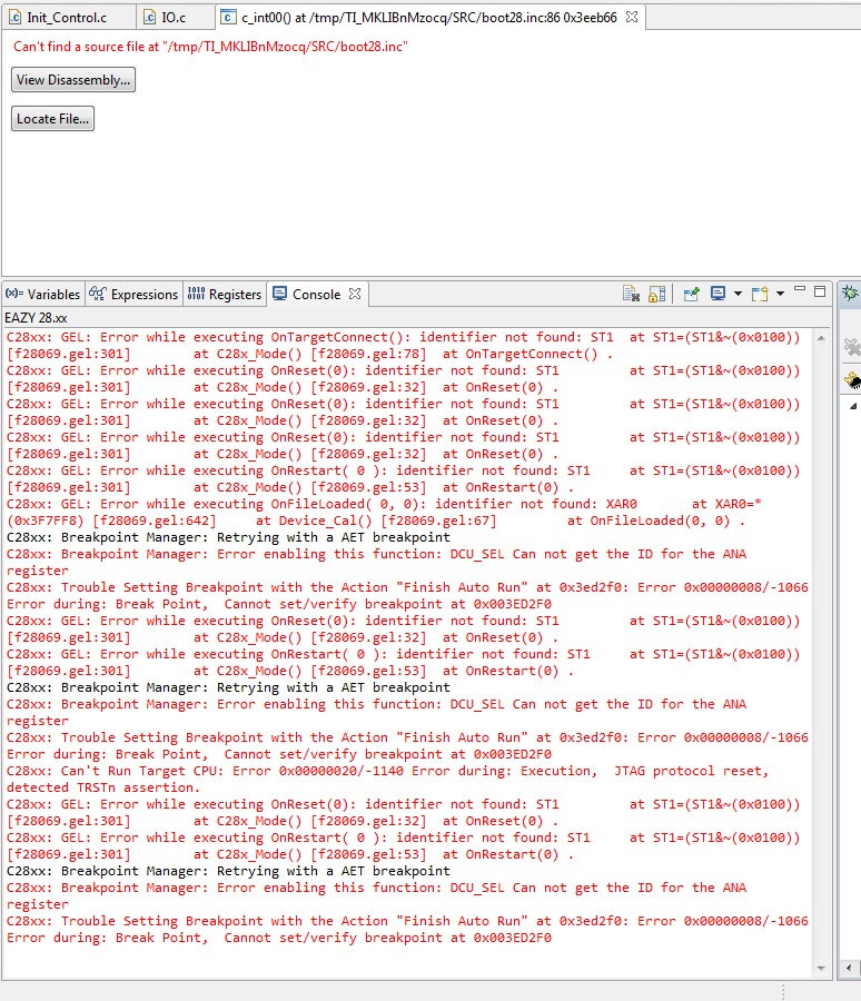

Can't find a sources file boot28.inc in CCS5.5
Other Parts Discussed in Thread: TMS320F28069F
Dear all,

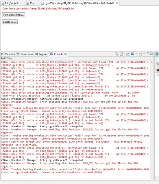

I installed new CCS 5.5.0.00077 and code generation tool 6.2.3 in my computer. I am using TMS320F28069F controller. When I downloading program in controller using USB JTAG XDS510LC spectrum digital; at end of program below error generate. And program can not go to in main routine automatically.
Also I can not put break point in code any where. When I put break point in code below error was generated.
Can any one face this type problem? Waiting for solution.
I already used CCS5.2.0.00069 and 6.1.4 CGT, but never face this type problem.
