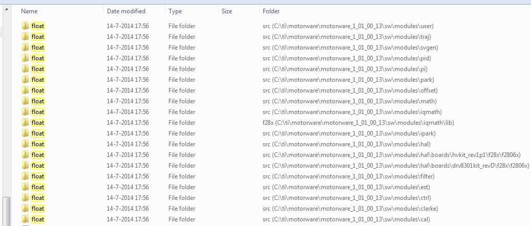

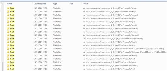

    Also in the modules folder there are many modules that are both 32b and float. Lab 5g is using 32b modules where there are float modules as well. Can you explain?

    For the encoder module, I think it should be left as IQMathLib.h, because this is a key motor control component and should be done in fixed point rather than floating point.  In Chris' comment he mentions that the motor control libraries are all done in fixed point so we need to make sure the supporting encoder module is also fixed point.
    I believe that the float modules were added prematurely.  See this post for more information: http://e2e.ti.com/support/microcontrollers/c2000/f/902/t/350468.aspx

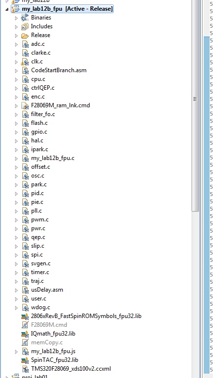

    I'm not getting much succes with adding fpu to lab12b. My steps are following:
    1) Copy lab12b as described in : http://e2e.ti.com/support/microcontrollers/c2000/f/902/p/332326/1159207.aspx#1159207
    2) Replacing FastSpinROMSymbols, IQmath and spinTAC with the fpu32 version.
    3) changing the properties according to lab5g
    The lab compiles without errors, but it will not work. First indication is that the bus voltage is not showing (value stays 0) with sysENABLE set to one. also lsd_H and lsq_H show wrong values when setting Run_Identify to one.
