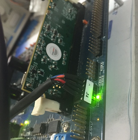

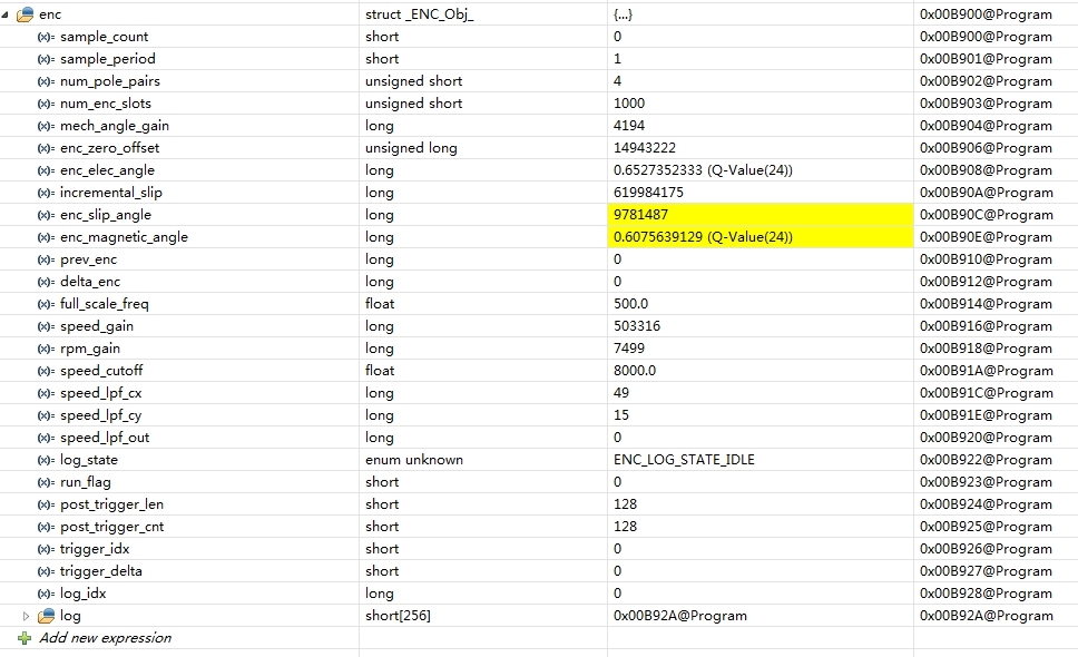

  • Hello,Chris.
    I did experiments on DRV8301-69M-KIT and used motor:Teknic M-2310P-LN-04K.
    I have modified the code of lab12b according to lab5a.It has become sensored torque control.
    The motor run well with sensored torque control.
    But I found motor can not produce a torque when I pinched the shaft of motor by my hands(make speed =0).
    I do not know why.Are there some mistakes in my modified code?

  • you are saying that when you stall the rotor (provide more load than the torque it can produce) the rotor completely stops producing torque?
    that doesn't make sense...
    what is your Iq_Ref_A command?
    is ForceAngle disabled?
    have you looked at the angle being provided by your encoder?
  • Hello chris.
    "you are saying that when you stall the rotor (provide more load than the torque it can produce) the rotor completely stops producing torque?"
    Yes,the rotor completely stops producing torque and I got the same result Whatever make ForceAngle enable or not.
    "what is your Iq_Ref_A command?"
    Iq_Ref_A = 0.3 ~ 0.35
    "have you looked at the angle being provided by your encoder?"
    When I run the motor by my hand,I found gMotorVars.SpeedQEP_krpm changed.I think encoder can work.
    I suspect the system used the angle which came from "FAST" but not encoder.Nevertheless, I can not find mistakes in my modified code.
  • 1. disable force angle all the time when using an encoder
    2. I would look at the actual angle being used by the CTRL during normal operation and at standstill with a load. This could give you some idea of what the problem could be.
    3. if you used the project of lab12 the angle being used in CTRL should be from the SpinTAC mechanical to electrical conversion block
    Now,I have made force angle disable:
    Actual angle?? I think it is the variable "enc_elec_angle".If so,add structure enc which contains enc_elec_angle to watch expression.then I execute programs......
    I set Iq_Ref_A =0.35,the motor run 3KRPM.I found enc_elec_angle was changing all the time and the bus current was 0.3A.
    Then I stalled the motor by my fingers.It stoped very easily and  the bus current was 0A (In my view if motor produces torque at 0 speed,  the bus current should be more than 0.3A).
    enc_elec_angle changed ever so slightly.0.652xx~0.653xx

  • I assume your project uses ctrlQEP correct?
    in this file you will see that electricalAngle is the electrical angle being sent into the control system.
    you should observe this value
    it certainly doesn't seem like the stator flux is being produced at the correct angle relative to the rotor flux
  • "in this file you will see that electricalAngle is the electrical angle being sent into the control system.
    you should observe this value"
    OK,electricalAngle is not a global variable,I can not observe electricalAngle directly.So I added a global variable "gElectricalAngle" in ctrlQEP.c for test.
    Then I executed programs......I got the same result as above:gElectricalAngle was changing all the time when the motor run.If I stalled the motor by my fingers,the value of gElectricalAngle hardly changed.
    Moreover,I can not find any abnormal phenomena about the motor phase current.
    And I think the phase sequence of motor is correct according to the directions:
    The board and motor all bought from TI.So engineers in TI can use DRV8301-69M-KIT to run Teknic M-2310P-LN-04K motor by my code file lab12b.c.I think you will dope out a solution to the problem quickly.

  • when using a properly aligned encoder, when you apply load greater than the torque command, it should stall the rotor but still provide the torque commanded.
    yours is not, which suggests that the angle being used in the control system is incorrect.
  • My experiments' result : no load was present,if I set gMotorVars.IqRef_A = 1.0,the motor span quickly (about 11Krpm) and the bus current was 1.1A.
    Now let us suppose the angle being used in the control system is correct.Then when you apply load greater than the torque command,What do you think how much the bus current should be ?
  • I don't know what the bus current should be. There isn't a fixed relationship.
    I know that your Iq_Ref_A will saturate to the USER_MOTOR_MAX_CURRENT_A value in user.h
    And with an encoder torque should continue to be provided.
    Having your bus current larger than your IqRef value is surprising. It leads me to think that your Id is not controlled well (because the angle is incorrect) resulting in non-zero Id which results in a larger total current.
