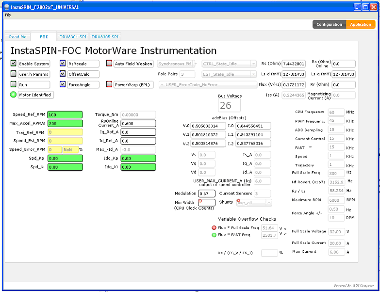

    During the ID motor, It is happened that:
    ES_State_RampUp : the motor spins
    After, the motor stops
    ES_State_Ls : the motor start spinning with ripple . (when I show the signal of Hall sensor on the scope it isn’t periodic signal)
    I test several times and the parameters change all the time.
    I enclose different pictures, with Lab2b or Lab2c, Ls didn’t find correctly.
    All the time, I put 32V in the supply (PVDD-GND of my board), but all the time in the HMI you see only 26V.
    The input voltage delivered to the motor must be lower than 34V.
    The R line-line is 13.5 ohm and L line-line is 5.5 mH. The max permanent power is 15W.
  • the 2nd graphic looks like it ID'd correctly with Line-Neutral values.
    The BOOSTXL-DRV8301 only support 24V. It actually measures 26.314V maximum, so putting in more voltage is not advised and why it clips to the 26V it can measure.
