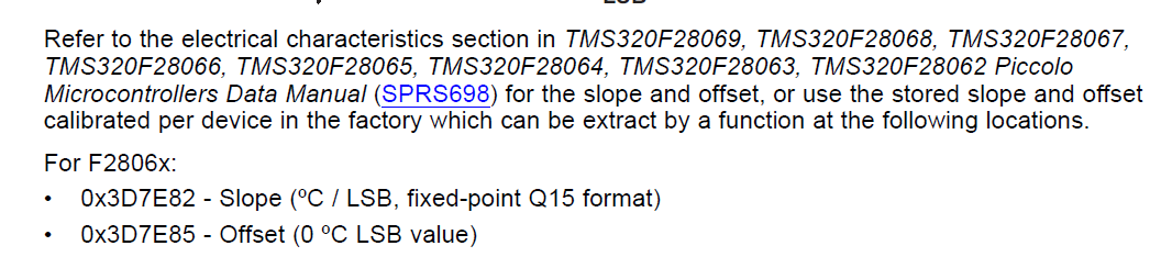

  In TI's examples, the slope of temperature sensor is gotten by a function pointer as shown below:
//the address is 0x3D7E82
  #define getTempSlope() (*(int (*)(void))0x3D7E82)()
return ((sensorSample - getTempOffset())*(int32)getTempSlope() + FP_ROUND + KELVIN_OFF)/FP_SCALE - KELVIN;
I use a variable pointer to get the data as shown below:
//the address is 0x3D7E83
int *getTempSlope = (int*)0x3D7E83;
slope = *getTempSlope;
They can get the same slope. But be careful that they use different addresses.
Tommy told me there is something about the  op-codes but  I really don't know the reasons.
I am looking forward to your reply.
best regards.
Di
  • ok!!!!!!!!!!
    I know the truth is that I didn't read the datasheet carefully.
    The function pointer is pointed to a function!
    use the stored slope and offset calibrated per device in the factory which can be extract by a function at the following locations!!
    So there is a function called and then it return the right value...
