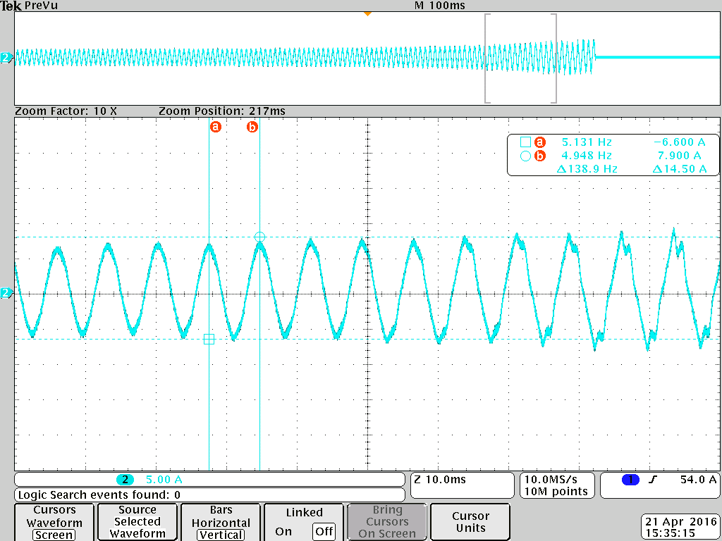

  • Hi, Ramesh,
    I use the controller kit to do a motor load test but get an error again.
    The test is: I use the controller kit to drive a motor to run at 3000 rpm, and slowly increase the load of the motor, as the load increase to about 0.3x Nm, the controller stopped and LED1 and LED2 flush continuously. Could you please suggest what may cause this error?
    I used the 2.1 version, and set the based frequency to 250 Hz, BUILDLEVEL7, 10 poles, and set the Rs, Ls as the motor's real resistance and inductance. The motor is started at open loop with reference set to 0.2, then change to close loop, then set the reference to 0.999. The motor runs good at no load. The controller is powered with the 15V DC power supply, the fan power connected and it is running during the test. The DC inverter uses 120V AC power supply via a variac.

  • Hi, Ramesh,
    I did not change anything of the board. I measured the phase current, and its peak value at the moment error happen is about 9.5 A, I think maybe it triggered the OCP. But the input power is about 180 W (output about 130 W), the rated power of the motor (output) is 320 W, so I need to test it with input power 400~500 W. Why the phase current is so large while the input power is only 180 W? Is it possible to use this kit to test the motor at its full rated power?
    Below is the captured phase current at the time the controller stopped due to error.
  • BTW: I contact the motor maker, it is said that the peak phase current at rated output is about 6 A, but now the power is only about 40% of its rated power, but the current is so large, is anything wrong for the control? I set the closed loop speed to 3000 RPM during the test, and the motor speed at its rated output is about 2600 RPM, I also noted that the motor speed always keep 3000 RPM as I increases the load until the motor stop due to error.

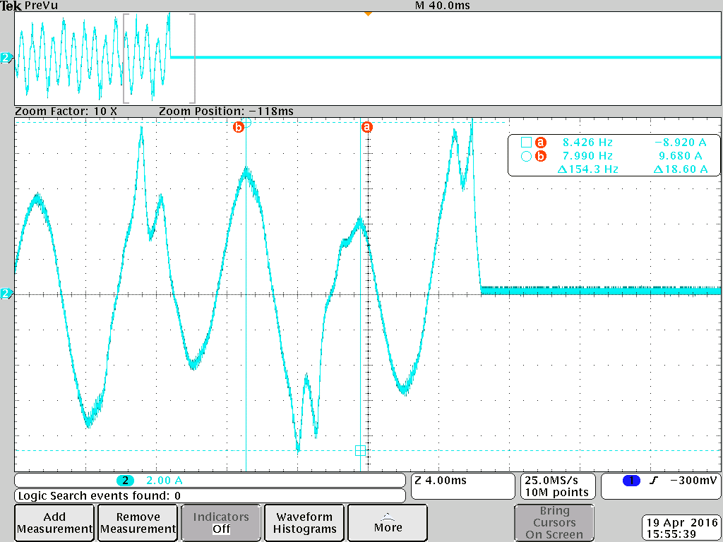

  • Hi, Ramesh,
    I test the motor with various speed and various load, and found that the motor will enter error mode at different load under different speed. Below is the testing results:

    Also I found that when the motor is about to enter error mode, the phase current gets distortion, as see the figure below. I think maybe the controller did not estimated the rotor position correctly at the time OCP happen. The motor I tested is IPM motor, whose Ld is not equal to Lq, but in the software, I did not see any choice of IPM or SPM motor, I only uses a mean inductance. Also, the motor's B-Emf Constant is usually needed when control a motor, but I did not see anywhere to input this motor parameter. Is it is OK with the above motor paramter settings? Does the software use some advanced control method like field-weakening etc.?
  • Since it is a voltage based model, subtracting the resistance  and inductance drop should take care of obtaining the bemf and there fore, bemf constant is not critical in this implementation.
    For the speeds you are testing, Ld and Lq inaccuracies should not cause control failure at lower loads. If anything, I would consider making the magnetic field stronger by setting positive IdRef and see how the system responds.
    rgds,
    ramesh
