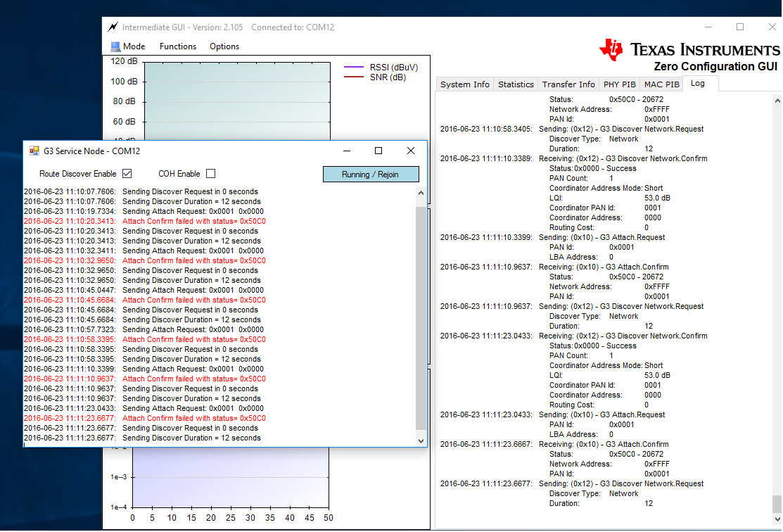

  • Hi Meghana,
    Thanks for the reply.
    I have tested a L&G meter and a L&G DC with single phase and the connection is working fine.
    I have also tried connecting PLCv4 kit with the L&G DC. This is not working. Please check the below image for the error message when I try to connect to the DC.
    I am not aware of such sniffer tools. Could you please suggest one.
    Vamsi.
  • hi Vamsi ,
    The error that you see is 0x50c0 which is for ADP_STAT_AUTH_FLR. This happens if the authenticator cannot authenticate the peer (unacceptable Responses to one or more Requests),
    then after unsuccessful completion of the EAP method in progress.
    Is the psksvr_AM335x running in the DC ?
    Are the keys like the psk key (PIB adpPSK 0x1F ) set the same for both DC and SN ? The join would be declined in such case ...
    use send raw data in SN side .( key is 0x3C 00 FF FF 0F 00 00 00 00 00 00 00 00 00 00 00)
    0x0D 80 1C 00 C2 44 5C D1 1F 00     0x00 00 00 00 10 00 3C 00 FF FF
        0x0F 00 00 00 00 00 00 00 00 00     0x00 00
    Use pskeuilist to set key at DC for the SN
    details of the same on how to create the pskeuilist etc given in 1.1     Default example PSK Server of TI G3 DC Interface Guide.
    Regards.
