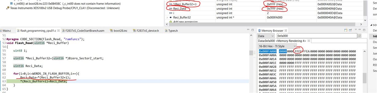

I read the data from the flash. But the data isn't correct. The following is the function that read data from Section Z.
#pragma CODE_SECTION(Flash_Read, "ramfuncs");
void Flash_Read(uint16 *Reci_Buffer)
uint8 i;
uint16 *Reci_Buffer32=(uint16 *)Bzero_SectorZ_start;
uint16 Reci_Data;
for(i=0;i<=WORDS_IN_FLASH_BUFFER;i++){
Reci_Data=*(Reci_Buffer32+i);
*(Reci_Buffer+i)=Reci_Data;
The value of *(Reci_Buffer32+i) is 0xffff that can display in watch windows. But the Reci_Data is change to 0x7fff. I don't know the reason why cause this issue. I appreciate if you can give me some suggestion. Thanks.

  • The system frequency is 200Mhz. You can see the value of *(Reci_Buffer32+i) from Watch windows is 0xffff that is the same value in the memory windows. The address is 0xfa002. That means the data is successful reading from flash. The issue is the variable Reci_Data on the left expression can't get the value on the right expression. it's so weird.
    BTW, The data read from 0xfa000,0xfa001 and 0xfa003 are correct and Reci_data can also get these correct value. thanks

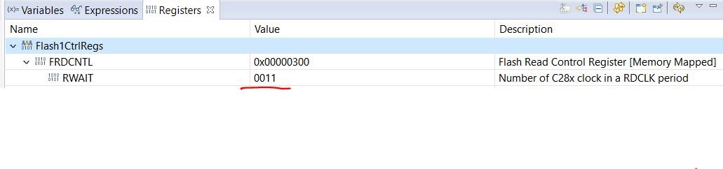

  • What is the RWAIT configuration inside FRDCNTL register? Can you make sure you have configured the value of at least "3"?
    It is possible if RWAIT is not configured to the minimum required value as per the data sheet, then you are reading data early and hence the value in "Reci_data" is not correct. Now when you look at the expression *(Reci_Buffer32+i) in watch window it gets evaluated multiple time, and hence the value that you read is correct since the data becomes available when you do multiple reads.
    Nirav
  • Hi Nirav,
    Thanks for your reply. The RWAIT in FRDCNTL register was "3".  The "Reci_data" can got the correct value 0xffff when I debug with step by step. But the "Reci_data" will get wrong value 0x7fff when I run the program without any breakpoints.  I appreciate if you can give me more help. thanks.
    BTW, The same issue will happen when I changed RWAIT to "0x6" or the maximum value "0xf". Thanks
