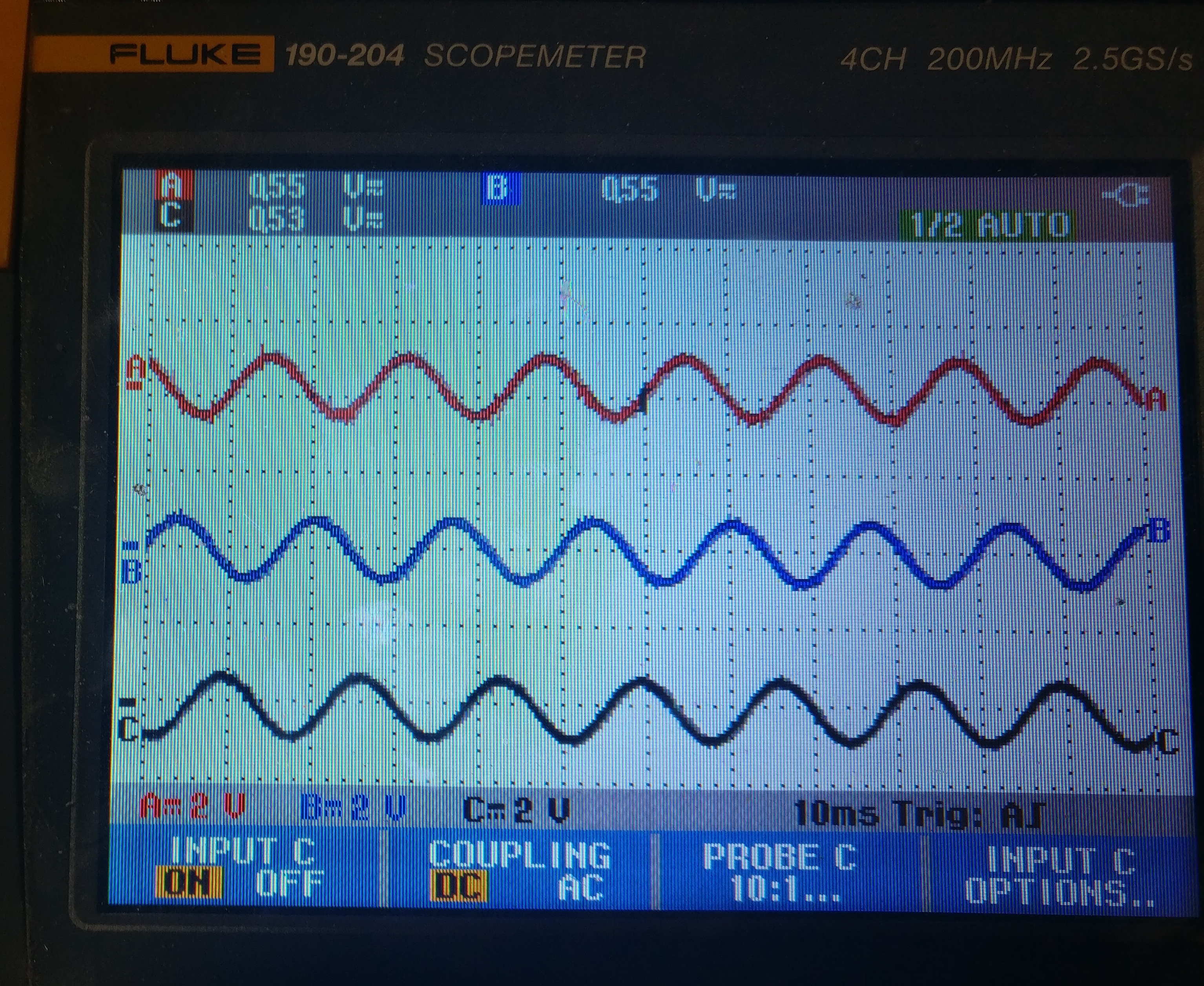

Hello all,
i am having an issue i with my ADC configuration. Please see attached images. There are three sinusoidal sync pulses of same amplitude but different phases being read by three ADC channels. Each of the channels have to read this sync pulse and an additional DC offset calibrated in my docking board. The ADC conversions of the three inputs are SOC2, SOC3 and SOC4. But when i look at the ADC results in the watch window(see image attached of watch window),  I can only see SOC3 and SOC 4 update its values. SOC2 remains frozen and only reads the DC offset much like other ADC results in the image. What could cause this to happen?? i can rule out hardware issues as i measured the offset on the respective pins and also measure the sync pulses to be identical in amplitude and physically checked if that voltage is being fed into all three pins.
The issue is only with SOC2 and the peculiar thing is when i change SOC2 to other adc channels, the problem persists, which leads me to believe it must be something to do with the ADC configuration.
my ADC config code is below. And i verified that  Adc1Regs.ADCSOCFRC1.all register is set to 0x007f and that there are no overwrites to this value.

  • Tommy,
    When i said ADCResult2 does not get updated, what i mean is i am feeding sinusoidal pulses to the three channels whose corresponding ADC readings are reflected by ADCResult2, 3 and 4. While the ADCResult3 and ADCResult4 update and change their values according to the sinusoidal input, ADC result2 does not recognize it. it stays frozen and just reads the inherent 1.5V DC offset. (sown in the screenshot as 0x0749).
    issue is with the ADCResult2 not reading the sine wave?
    Srini
  • Tommy,
    i made a few hardware changes and ran the system again, ADCResult2 will still not recognize the sine wave. But more importantly, i believe my ADC interrupt overflows. ADCINTOVF gets set to 0x0001. The ADCSOCFLG still is 0x0000. i will have to troubleshoot where the interrupt overflows and then maybe i will get a clearer picture as to why the ADCResult2 will not recognize.
    I have assigned Adc1Regs.ADCINTFLGCLR.bit.ADCINT1 to 1, any idea why it still causes the overflow. do i have to reduce my interrupt frequency to accommodate all the SOC's? could that be the reason?
    Thanks for your time and assistance,
    Srini
  • Srini,
    Thanks for clarifying the issue.  I was interpreting "update" strictly from a hardware register standpoint.
    Yes, I would recommend that you slow down the SOC trigger frequency until the overflow goes away.  You can try disabling all other ISRs as well.  Since there is no interrupt nesting on the C28, a long ISR can often block other ISR activity long enough to cause an overflow.
    -Tommy

  • Yes, that's right. I get an accurate conversion for every SOC except SOC2. Conversely, setting the input going into B0 to other SOC's also checks out. Setting the Channel BO to another SOC also works well.
  • I understand, I will give this a try and get back to ou with my observations. Thanks for your time.
