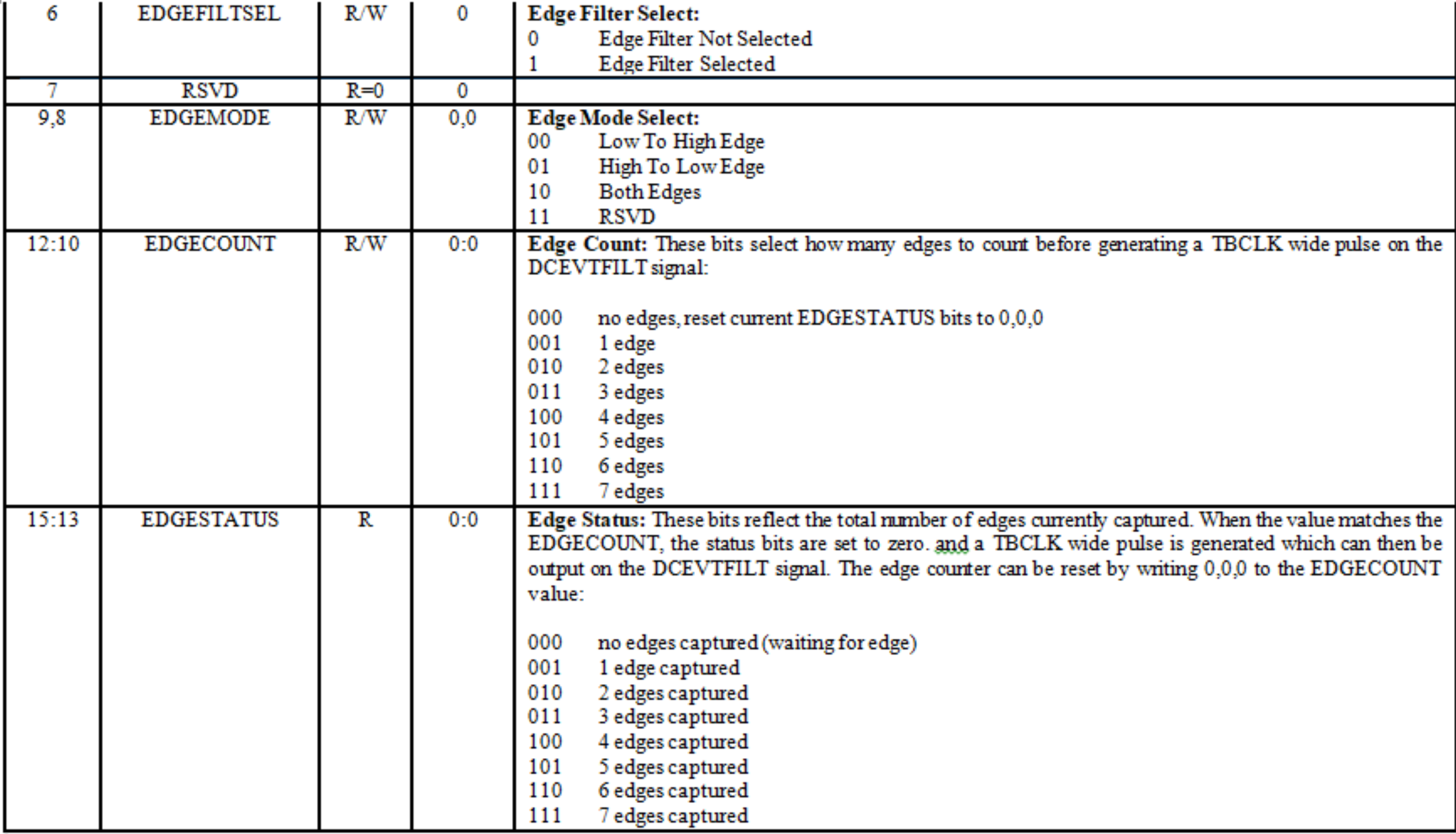

I was examining F28377x Technical Reference Manual / Revised January 2019.
In page 1767, manual tells about below configuration bits.
2. Configure the edge filter to capture ‘n’ rising, falling or both edges through the edge selection logic
(DCFCTL[EDGEMODE, EDGECOUNT]).
In page 1928,  at DCFCTL Register Field Descriptions EDGESTATUS, EDGEFILTSEL and EDGEMODE bit descriptions seems missing.
Could you provide the missing bit definitions?
