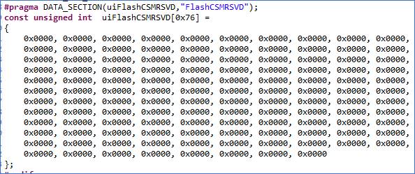

In the F2803x family, this was relatively easy:
  1. Write 0x0000 to CSM_RSVD locations (starting from 0x3F7F80)
         2. Write PASSWORD (128-bit) to CSM_PWL_P0 locations (starting from 0x3F7FF8)
3. In the main() function, we “lock” the DSP by calling CsmLock() which is a function already defined in DSP2803x_SysCtrl.c.  If we want to debug, then we simply comment-out and not call CsmLock()

    The F2803x examples I showed is a snippet of our actual code. Security is enabled and passwords are automatically written into the correct MCU locations when the MCU is programmed the first time.

    There is an DCSM example in C2000Ware (<C2000Ware>\driverlib\f28004x\examples\led). It is only sample asm and link cmd file which need to be included in main project and also the security settings need to be updated as per usecase.
    SPRT731A did not discuss security, so I still don’t which exactly is the CSM_RSVD and CSM_PWL_P0 locations for Potenza.  I think it is one of the registers described in TRM Table 3-17 but I’m not sure.
    All the security settings are in USER OTP (not register) which need to be programmed with different security settings. Passwords locations part of Zone Select block and address for Zone Select block can be changed by changing the link pointer so that if needed user can update some of the security settings (e.g. password value) in future.
