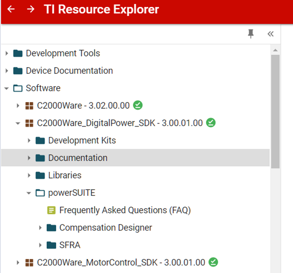

I would like you to confirm how user use solution adapter by using CCS10.
According to following URL, user can confirm how user can use solution adapter. And also I have confirmed following URL to understand flow of Digital Power SDK.
www.youtube.com/watch
www.ti.com/.../POWERSUITE
However, I can not find solution adapter inside PowerSUITE as shown below.
Is there any lack to perform solution adapter ?
  • Hi.
    Please note that the youtube link you have referenced is no longer up to date. In order to view the solution adapter pages, please navigate to the 'Development Kits' folder in TIREX. Over there you will find all the solutions supported. Once you select a solution, you can import into CCS and the main.syscfg page will open. Please reference SPRUII8 for more details  on the latest changes for the solution adapter.
    Ozino
    I have already confirmed SPRUII8(section 1.4 and 1.4.1) as well.
    However, this is described constitution for new powerSUITE(3.00 or later), not described how user can start.
    So, I confirmed youtube video.
    I understood that TI recommend to use usecase which is included in "Develpment kit".(I can see sysconfig in CCS project of "Development kit")
    In other words, I understood TI do not recommend to create configuration model from scratch.
    Is my understanding correct ?
    If you want to customize the solution/model for your system, there is a non powerSUITE version of the project that you can fully customize without the SysConfig/powerSUITE support. Details on using the SysConfig based solution adapter can be found in the respective user's guide for the chosen solution. You can find a link to that on the TIREX page.
