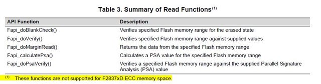

SPNU629A has the following description.
For example, if I do a Blank check after Erase, can I assume that when I call Fapi_doBlankCheck(), the program area is Blank checked but the ECC area is not Blank checked?
Is there a way to do a Blank check on the ECC area?
