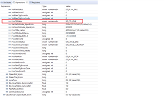

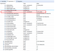

The picture below is a screenshot of “spintac” when the motor has current noise but no torque actually occurs after "servo on". Please help analyze it. What might be wrong?

    I am using 28069M with my customized PCB board.  Initially, I write my source code based on the TI example proj_lab13b.  This example project is used to realize position control, originally it works. But when I add more and more my source code on it, the position control does not work when servo on. In position control mode, the current noise on the motor can be heard when servo on, the motor rotor is free, it looks that there isn't any torque generated on the rotor, at this moment, when I examine the Spintac.posctlstatus, it is "st_ctl_idle", but not "st_ctl_busy".  Since when I initially start the source code programming on the board, I have examined that when servo on, the Spintac.posctlstatus is "st_ctl_busy", the motor work in position control mode. So, currently, it is "st_ctl_idle", I believe something wrong. But I have looked through the whole source code, the most of them are similar to the original source code of proj_lab13b. The figure below is the screen shot when servo on.

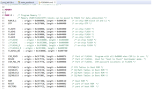

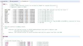

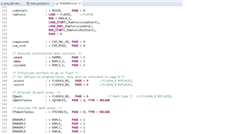

  • This is my modified F28069M.cmd:

    The below is the code before main():
    The below is code in the start of main()
    The below is the code in F28069M.cmd

  • I got the reason.
    Today, I find gmotorvars.spintac.error_id =2; the error ID sometimes is 2  but sometimes display 0; 0 means no error. 2 means cfg.velmax is beyond (0, 1);
    So I find the settings:
    STPOSCTL_setVelocityMaximum(obj->posCtlHandle, _IQ24(USER_MOTOR_MAX_SPEED_KRPM * ST_SPEED_PU_PER_KRPM));
    for term "USER_MOTOR_MAX_SPEED_KRPM * ST_SPEED_PU_PER_KRPM" , the result should not be higher than 1.0; if it is >1.0, then error id =2;
    Since in my setting,
    USER_MOTOR_MAX_SPEED_KRPM =5;
    ST_SPEED_PU_PER_KRPM = (USER_MOTOR_NUM_POLE_PAIRS / (0.001 * 60.0 * USER_IQ_FULL_SCALE_FREQ_Hz));
    USER_IQ_FULL_SCALE_FREQ_Hz= 300;
    Therefore, ST_SPEED_PU_PER_KRPM= 0.222;
    then, USER_MOTOR_MAX_SPEED_KRPM * ST_SPEED_PU_PER_KRPM = 5*0.222 = 1.11 >1, therefore, which result in the cfg.velmax >1; then error ioccurs.
    when setting  the USER_IQ_FULL_SCALE_FREQ_Hz = 500 ( or higher), then the position loop can works.
    But, these days, the error_id is always displayed 0 in CCS watch windows. Today, it is displayed as "2"  sometimes for a  very short time; then I captured that moment. But why it is not always displayed as "2" ?  CCS watch window  is continuous refresh setting.
