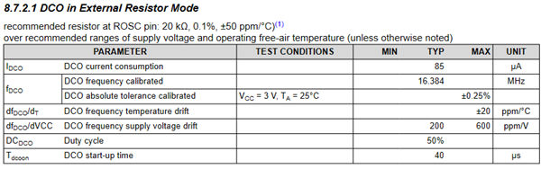

I have a customer trying to spec UART clock drift over time on the MSP430I2040. Do we have a spec on the overall accuracy of the clock over time, or should we just use the maximum absolute tolerance spec in the datasheet?

    There is no spec for drift over time.  I would just refer the customer to the max tolerance.  I assume they would be using external resistor to help control DCO accuracy.
  • Hey Dennis,
    Ok, thanks for the feedback, we need to take into account the voltage and temperature drifts if using the max tolerance, or is that already figured into the overall max?
    Munan
  • Unless noted otherwise, the specifications in the data sheet are typically over recommended ranges of supply voltage and operating free-air temperature.  Here is an example.
    Here is an example where they show drift and accuracy based changes in temp or changes in voltage or both
    So although we don't show drift over time, you can see the %drift due to temp or voltage or both.  If the customer is worried about baud rate accuracy over time, use and external resistor with the 50-ppm TCR or better and that will keep the accuracy of the clock well within the tolerances of the UART.  Make sense?
