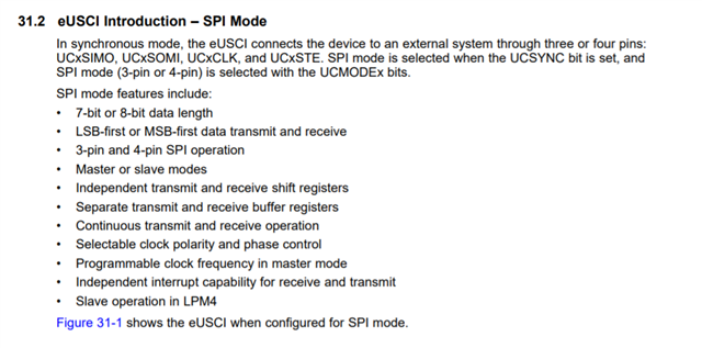

I want to know if there is a limitation of characters(bytes) when using the SPI?

Hi Qingyun,
Usually you will transfer 8 bits (1 Byte) at a time, but there is no limits to how many times you can send a byte. Below is the overview of the SPI mode for the MSP430FR5994 taken from the MSP430FR5994 Family User's Guide.
