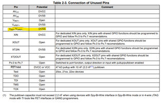

Hi all,
If I wanted to hook up the an External VREF to the MSP430F2274, do I just need to hook up the VREF+ pin to the external VREF or do I also need to hook VREF- to Ground?
It seems like I only need to hook up the External VREF to the VREF+ pin and that the “ground” can be set to use the AVSS pin by setting SREFx to “010”.
I would appreciate any confirmation on this since the datasheet does not it make it clear.
