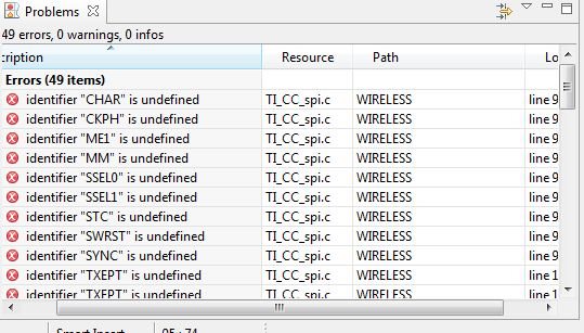

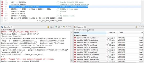

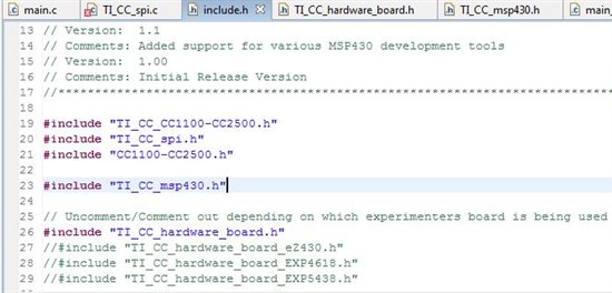

    STEP 4: I then assigned the proper values to TI_CC_RF_SER_INTF in the TI_CC_hardware_board.h which is shown directly above
     I tried to debug and run this code and I run into errors when the code tries to initialize the SPI bus pictured below:
    Am I missing an include file somewhere or something?
    I hope that I am not posting to many questions at a time, please let me know if I am.
    Thanks for the assistance so far
    --David
  • Looks like it's compiling for the wrong serial device.  I don't know the code, but I just scanned it quickly to find that you probably need to set
    TI_CC_RF_SER_INTF to be TI_CC_SER_INTF_USI
    in TI_CC_hardware_board.h
    Jeff

    // USI interrupt service routine
    #pragma vector=USI_VECTOR
    __interrupt void universal_serial_interface(void)
      if (0x10 & USISRL)
        P1OUT |= 0x01;
      else
        P1OUT &= ~0x01;
      USISRL = P1IN;
      USICNT = 8;                           // re-load counter
    thanking you in advance
    sanchay arora
  • How did u do that? Would u mind showing me how did you fix this problem? I am currently stuck into this part. Thanks.
