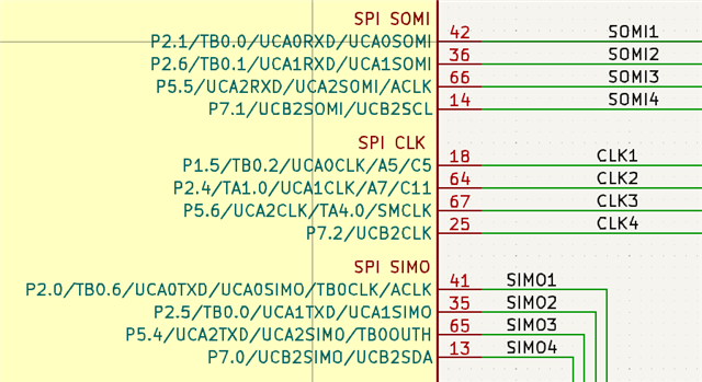

I am using the MSP430FR5994 in one of our projects, and everything is working well on the prototype board, except for the SPI bus.
I've tried both to write my own test program as well as using some of the official TI examples, but I can't get it properly working.
What happens is that with both my own as well as the TI code, none of the CLK lines work. CLK stays low, no matter if I enable "CLK inactive high mode". It also doesn't matter if I transmit data or not.
Also, at all times only one of the 4 SIMO lines will transmit the data I am asking them to transmit. The others will stay low.
I haven't tried to interface with the SOMI lines yet, as the MSP is the master and I need a working output first.
Otherwise the MSP430 works as expected, including the UART mode. I am using Spy-By-Wire to debug it through the CCStudio, and looking at the transfers from a debugging side they should work as expected.
Both my code, as well as the TI example code produce the same result on the MSP430FR5994 LaunchPad.
You can find both example codes for interfacing with the SPI attached.

  • Your connections use UCA0-2 and UCB2, but the Example code you posted uses UCB1, which is none of those. (I haven't looked at the .zip)
    Depending on which is easier, you can either (a) change the code to use (e.g.) UCB2 or (b) re-wire one of your SPIs to use UCB1.
  • Ah, excuse me for this error.
    At some point I edited the .c file to be used with the MSP-EXP430FR5994 launchpad. There UCB1 is exposed.
    However, there I also couldn't measure a correct SPI at UCB1.
    The Zip contains the code that actually runs on my prototype board.
