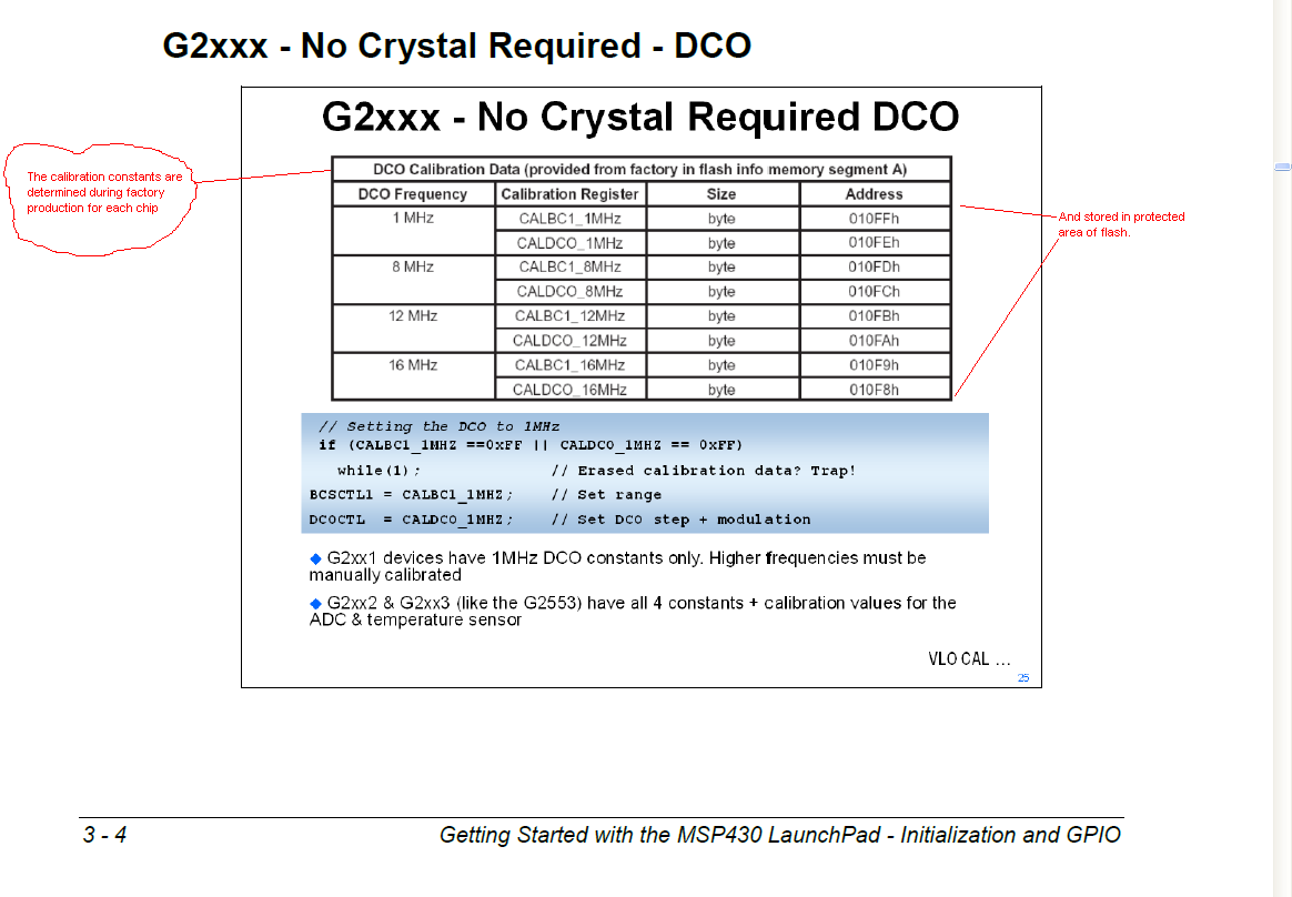

    Another thing - I think header is not consistent with the documentation. In datasheet (page 15) are different offsets for config data and different tag number for ADC...
    In case someone will need factory values of FLASH (INFO memory: segment A - 0x10C0-0x10FF), here they go:
    0x20, 0x70, 0xFE, 0x16, 0xFF, 0xFF, 0xFF, 0xFF, 0xFF, 0xFF, 0xFF, 0xFF, 0xFF, 0xFF, 0xFF, 0xFF, 0xFF, 0xFF, 0xFF, 0xFF, 0xFF, 0xFF, 0xFF, 0xFF, 0xFF, 0xFF, 0x10, 0x10, 0xFD, 0x7F, 0x00, 0x00, 0x3A, 0x81, 0xF3, 0x02, 0x00, 0x00, 0xAA, 0x81, 0xC3, 0x01, 0x00, 0x00, 0xFE, 0x08, 0xFF, 0xFF, 0xFF, 0xFF, 0xFF, 0xFF, 0xFF, 0xFF, 0x01, 0x08, 0x93, 0x8F, 0x9B, 0x8E, 0x8F, 0x8D, 0xD4, 0x86
    And helpful information about that stuff: http://ares.ee.nchu.edu.tw/Course.files/epr100/lecture11.pdf (page 26 especially).

  • bienieck said:
    Katie, I have MSP430G2452 chip as a reference, in a way. So it is posible to copy MSP430G2452 configuration
    No. Each MSP (even two of the same model) require different calibration data. This is why it is calibration data, not generic constants.
    To restore them if lost, you have to recalibrate, that means compare the DCO speed to a known reference and adjust the DCO until they match and then store the resulting setting. This is what TI does at production time to determine the individual calibration data. (and if you spend more time than TI does, you might end up with more precise results than the original ones)
  • Hi bienieck,
    Jens-Michael is right, you cannot just copy factory calibration constants from another device. They are tested and programmed in per unit, so they will be slightly different on every device coming out of the factory. For an accurate set of DCO calibration constants you should use instead the code example that I mentioned above with a 32768 crystal on the board, to find new DCO cal constants specific for this particular device (or you could of course do it manually).
    bienieck said:
    Sure, DCO will work if I hard code factory constans, but I want BCSCTL1 = CALBC1_xMHZ and DCOCTL = CALDCO_xMHZ working properly with default library. Problem is, in my opinion, in header or compilator settings. But still, I don't now how to make it work.
    For this issue, please see this thread: http://e2e.ti.com/support/microcontrollers/msp430/f/166/p/310476/1089128.aspx#1089128
    Your problem may have been caused by a recent update in CCS of the header files, but these have now been reverted - if you already had the update applied you would need to re-install CCS, or if you don't want to do that I've provided the corrected files for MSP430G2553 in the post I linked above - you can just replace the files in CCS with these versions.
    Katie
