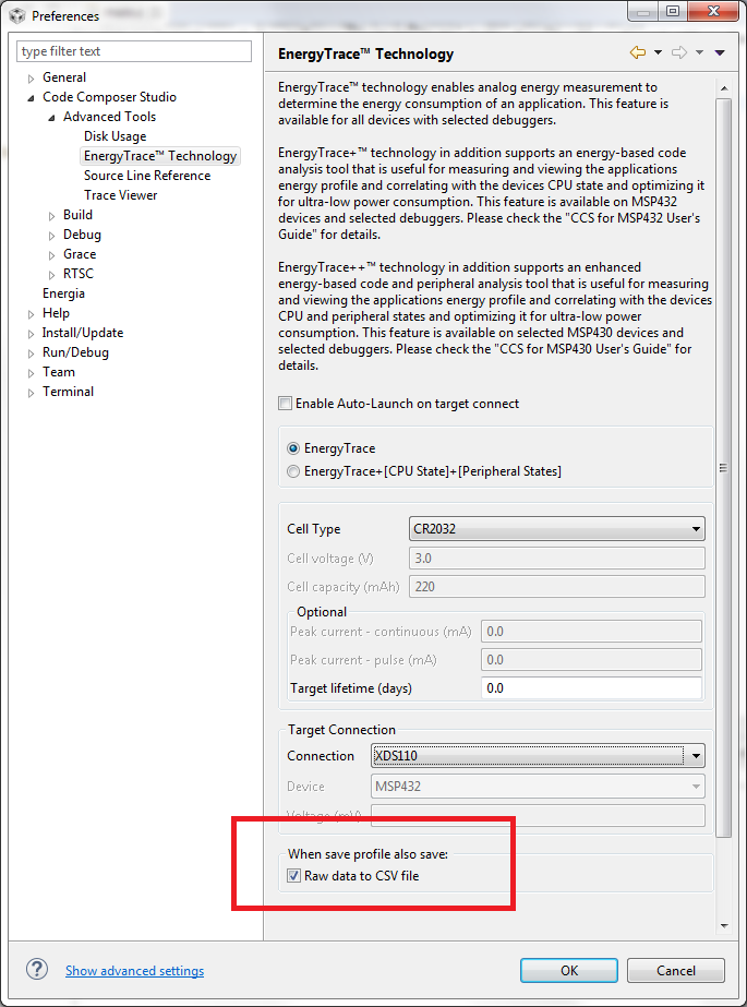

How to view the raw data of power and energy graphs of energy trace module for msp430fr5969?..how to view the .profxml file?
  • Krishna,
    For the moment we do not have a way to export this raw data outside CCS (.profxml), but this is something that we are looking into it.
    David

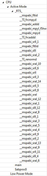

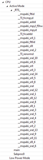

                     Is it possible to give the full form of components that come under RTS of Active mode when we do a Energy Trace ++ module. What does main mean in the active mode?...Any manual/guid e for those stuff?..
  • Krishna,
    The RTS (Run Time System Library) source code is part of your CCS installation. Please look in:
    C:\ti\ccsv6\tools\compiler\msp430_4.3.x\lib
    - rtssrc.zip
    RTS_4_3_x_Manifest.pdf
    David

  • Hi David,
    Any updates on this subject? Fyi, I'm using msp432 launchpad.
    Federico
  • Hi Federico,
     CCS v6.1.3.3.00033 support EnergyTrace CSV format, please make sure to enable it:
     David
