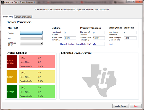

we have some strange behavior of the power designer GUI 1.1:
win7 - installation as admin - two different desktop-PCs.
After installation there is no calculation (Scan rate too high)
of the estimated device currentr with any system parameters nor system statistics.
Is there any hint for further investigation ? - normally no big deal to install.
Best regards
Dietmar

  • Thanks for the clarification.
    Are you able to see device/vcc/frequency options in the selection drop-downs, or is the device selection drop-down blank (as is shown in the screenshot below)?  I'm trying to make sure that the GUI is able to find the device configuration files correctly.  If for some reason they weren't there, you would see a screen like the one shown below.
    Walter
  • devices are o.k.
    DCO-f is o.k.- even with lower power lower frequencies to choose
    Vcc is without dot (36 instead of 3.6) but you can choose 36, 33. 27, 18

  • Hi Dietmar,
    I think this is an issue with how .NET is handling Windows 7 regional codes.  I was able to reproduce what I think is the failure you are seeing.
    Does the screenshot below match what you are seeing?
    Would you be able to test something on your end to verify that I have found the correct problem?  If you temporarily switch your regional settings in Windows 7 to "English - United States" and open the GUI, the problem should go away:
    I'm looking into a permanent fix for handling regions.  If this is does fix your problem, would you be able to share which region you are using?
    Thank you,
    Walter
  • Hello Walter,
    You are the best ;-)
    The screenshot is exactly what I saw.
    And the change of the region is the solution.
    I use (normally) "Deutsch(Deutschland)" = "German(Germany)".
    It seems to be aproblem with the decimal separator.
    Best regards and Thank you!
