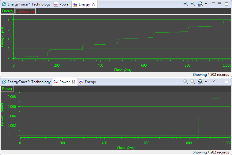

During firmware development I'm constantly using checking EnergyTrace. Today I saw something peculiar. Have a look at these plots, which come from the same run. Notice that the power plot doesn't agree with the energy plot. The energy plot shows 6 brief periods of increased energy consumption. The power plot should show 6 corresponding spikes. I was able to reproduce this discrepancy multiple times.
The code, with which these plots were produced.

My development environment: CCStudio 6.1.0.00104, MSP-FET via Spy-Bi-Wire, MSP430G2210.  I can post more details if needed, of course.
