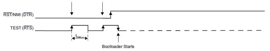

    When no sequence is applied, i.e. the MSP is left as it is, it stays in the else loop as you predicted. But, even after applying the sequence to it, the LED status indicates that it is still in the else loop. Hence, I believe that I am unable to put the MSP into BSL mode. I am unsure why that is, since the TEST and RESET sequence seems to be correct. The waveform as seen on the oscilloscope is as shown:
    I apologize for the poor quality of the image, but the waveform is similar to the one in SLAU319L, which is shown below:
    The value of t_SBW,en is 1 us according to the MSP430F5342 datasheet SLAS706E.

  • It seems to me that the BSL entrance sequence was not detected by the target at all.
    I know that TI documents say the timing is not critical. However, I found that some F5xx's (or FR's) are rather picky. I do not remember which, but I never tried F5342. You might want to try longer delays (up to 50 usec).

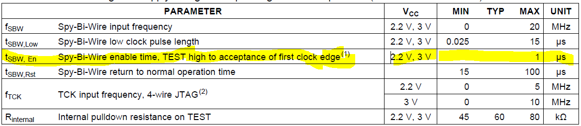

    I found some part of the documentation regarding timings confusing. The part is:
    SLAU319L says:
    "The BSL program execution starts when the TEST pin has received a minimum of two positive transitions and if TEST is high while RST/NMI rises from low to high (BSL entry method, see Figure 2). This level transition triggering improves BSL start-up reliability. The first high level of the TEST pin must be at least tSBW, En (see device-specific data sheet for tSBW, En parameter)."
    Which means that the pulse width must be more than tSBW, En.
    However, in the MSP430F5432 datasheet SLAS706E it says:
    Which seems contradictory.
    When I changed the timings to make the pulse width 0.1uS, neither of the LEDs are on, but the RESET pin is high. (Hence, MSP is not in RESET. Does this mean that it is in BSL? It still does not reply to commands like Mass erase.)
    Virag
  • (1) The timing requirements you quoted is for SBW operations, not for BSL entry sequence.
    (2) When neither of the LEDs are on, it means the CPU is not executing your code. It could be running the BSL code (but not working). Or it could be doing something else which we do not know.
