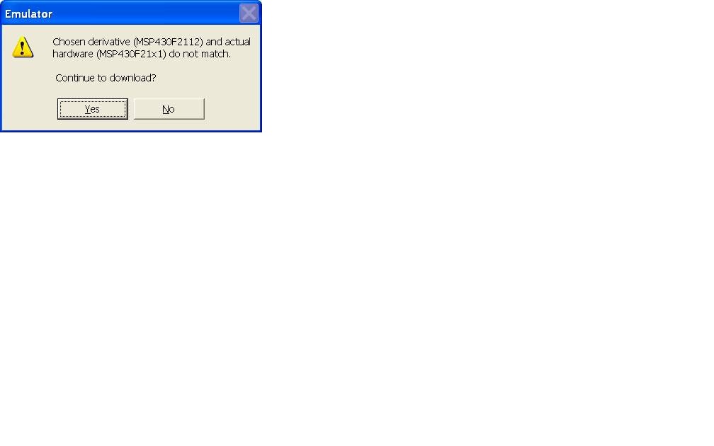

I am using an ez430-F2013 USB stick Spy-Bi-Wire 4-pin header to program an MSP430F2112IPW.
When I try and doenload and debug I get the following message:
Chosen deriviative (MSP430F2112) and actual hardware (MSP430F21x1) do not match. Continue to download?
Even though I selected Target --> Device --> MSP430F2112
Is this normal?
    The issue at hand is that the hardware supports F21x1 which means F2111, F2121, F2131, etc but not F2112, F2122, F2132, etc. For a novice, this can be confusing at first but each digit of the device number can imply different feature set and functionality.
    As an example, here are datasheets of F2121 & F2122:
    http://focus.ti.com/docs/prod/folders/print/msp430f2122.html
    http://focus.ti.com/docs/prod/folders/print/msp430f2121.html
    Notice that the only difference in the device numbers is the last digit changing from 1 to 2. And yet, the devices contrast in pin-count, ADC, Comparator, Flash Memory, etc.
  • Not clear by what you mean.
     I select the derivative: MSP430F2112
    I have a prototype PCB with an MSP430F2112IPW device installed.
    I am programming/debugging via Spy-Bi wire and the attached file is what I get.
    It says I am using different hardware?
  • Maybe this is answering your question as well:
    MSP430F2112 reporting as MSP430F21x1 device over multiple programmers/ compilers
    This was the first hit as I searched for F2112 in the keyword box at the top of the page.
